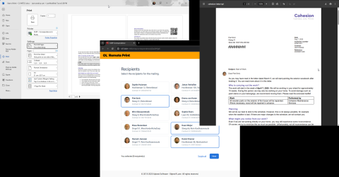

Collage of screenshots showing steps to personalize a document using a flow in OL Automate, with OL Remote Print and OL Connect. Steps described in detail below.

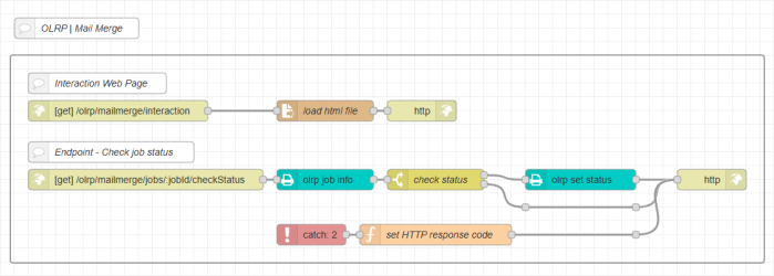

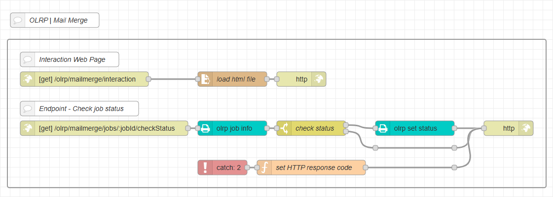

Check Job Status
The first flow group handles checking the status of the OLRP job, using the same functionality as in the standalone OLRP check job status.
The workflow developed for Check Job Status.
Once the job is fully received, the browser is redirected to a page where the user can select recipients or tenants.

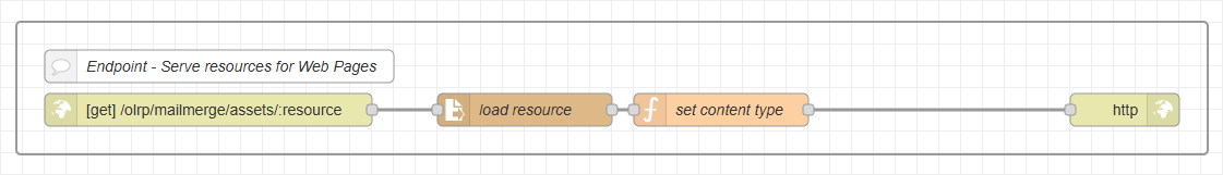

Resources endpoint
The second flow is an endpoint that serves the static assets required by the various web pages. These files are stored in the example’s assets folder and include the JavaScript files that provide front end functionality, as well as the CSS stylesheets that define the appearance of the pages.
Flow consisting of the following nodes: [get] /olrp/mailmerge/assets/resource, load resource, set content type, http.

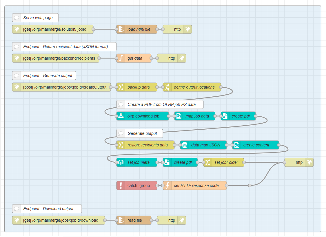

The third flow group contains the core functionality of the example. It serves the web pages with sample-specific features, provides endpoints for delivering data, and runs the flows that generate and download the final output.
Web Page flow
Serves the main landing page where users can:
  • Select one or more recipients/tenants.
  • Provide job-specific parameters (e.g., subject line, reference numbers) via a web form.
  • Submit the job to trigger output generation.
Recipient Data endpoint
Provides a list of recipient records via a REST API in JSON format.
  • In this example, recipient data is static or mocked.
  • In a real-world implementation, this would typically query a database or backend system to retrieve dynamic recipient information.
  • This data is loaded by the solution.js file and used to populate the web page.
Output Creation endpoint
This flow handles the creation of personalized output by:
  • Receiving data submitted by the web page, includes the selected recipients, subject, and reference fields.
  • Downloading the OLRP job from the OLRP server and converts the PostScript file to a PDF:
    • Using a creative workaround to convert PostScript to PDF via OL Connect's data mapping and output creation steps. This approach will be replaced by a direct PS-to-PDF conversion in a future version.
    • The output preset stores the resulting PDF in a job under workspace/olrp/mail-merge/jobs/.
  • Mapping the submitted JSON data and merging the data with an OL Connect template, where the OLRP job (converted to PDF) acts as a dynamic background. Overlay content is added using standard OL Connect composition techniques.
  • Writing the final PDF output to the job folder in the workspace, as defined by the Output Preset.
Download endpoint
Allows the web page to retrieve the final merged document for download.

Run the Mail Merge sample
  1. Open the Sample Letter file from the olrp/mail-merge folder in Microsoft Word.
  2. Go to File → Print.
  3. Select the OLRP printer configured for olrp/mailmerge/interaction.
  4. If everything is correctly installed, licensed, and configured, a browser window will open showing a busy indicator.
  5. Once the OLRP server has fully received the print job, the page will update to allow the user to select one or more tenants.
  6. Click Next, then enter a Subject for the letter.
  7. Click Submit to start the merge process.
  8. When processing is complete, a download link will appear. Click the link to open the generated output in a new browser tab.
