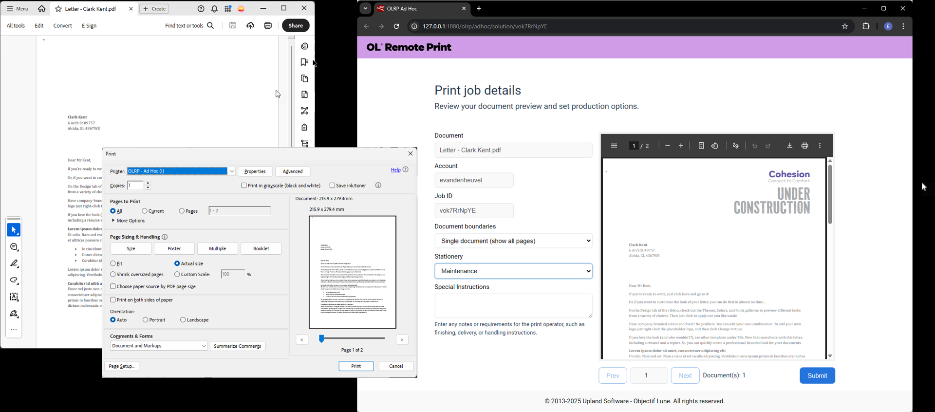

Through a simple web form, users can choose a stationery image to appear behind each page and set document boundaries, with the preview updating instantly after every change.
Collage of a word document with fields, a web page page with content options, and the final merged document.

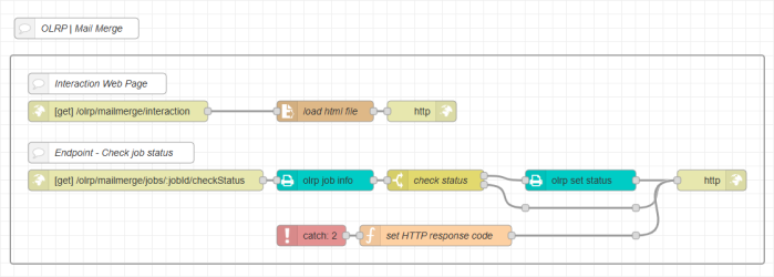

Check Job Status
The first flow group handles checking the status of the OLRP job, using the same functionality as in the standalone OLRP check job status.
Sample workflows for mail merge and check job status, as described in the text.
Once the job is fully received, the browser is redirected to a page where the user can select recipients or tenants.

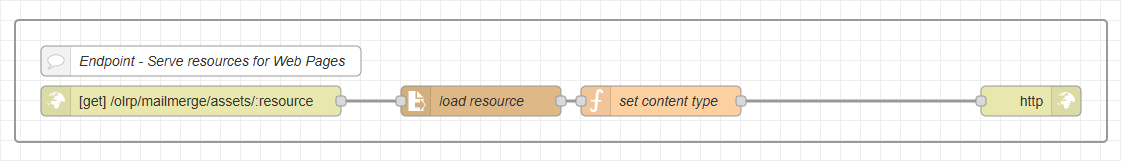

Resources endpoint
The second group of the flow is an endpoint that serves the static assets required by the various web pages. These files are stored in the example’s assets folder and include the JavaScript files that provide front end functionality, as well as the CSS stylesheets that define the appearance of the pages.

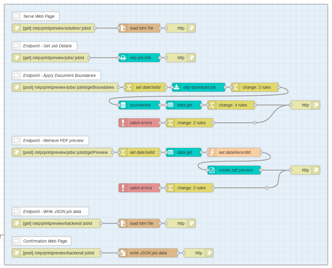

The third flow group contains the core functionality of the example. These flows perform the following:
  • Serve the web interface with sample-specific capabilities.
  • Provide endpoints for retrieving PDF previews and handling document segmentation.
  • Store submitted job data in structured JSON format for persistence and future reference.
Web Page flow
Serves the main landing page where users can:
  • View job-related information.
  • Select preferred stationery options.
  • Define document boundaries for mail-merge scenarios.
  • Preview the job in PDF format, with the ability to navigate between segmented documents.
Endpoints
  • Job Details endpoint: Provides static information for a given OLRP job, allowing the web interface to display this information.
  • Document Boundaries endpoint: Dynamically sets document boundaries using a data mapping configuration, creating datasets and records in the OL Connect database. It returns the dataset ID and document count, which is used for the preview navigation on the web page.
  • PDF Preview endpoint: Generates a PDF preview for a specific record within a dataset. The endpoint uses submitted JSON containing the dataset ID, record index, and stationery selection.
  • Write JSON Data endpoint: Saves submitted job data to disk, triggered when a user finalizes their print job. The file is found under /olrp/print-preview/jobs/
  • Job Confirmation page: Displays a static confirmation page to indicate successful job submission.
