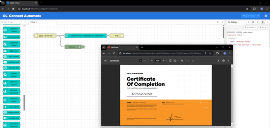

This exercise introduces you to OL Connect Automate by walking through the creation of a simple flow that serves a personalized PDF preview to the browser. You’ll build an HTTP endpoint in Node-RED that triggers PDF generation using an OL Connect template.
The flow outputs the content of a Print section from the template in PDF format, served directly via the HTTP response. You’ll use your browser to trigger the endpoint and view the generated PDF.
This example builds on basic OL Connect Automate and OL Connect concepts, and is also included as a sample flow in the OL Connect Automate package.
Screen showing this flow in the workspace, and the output - a personalized PDF.
