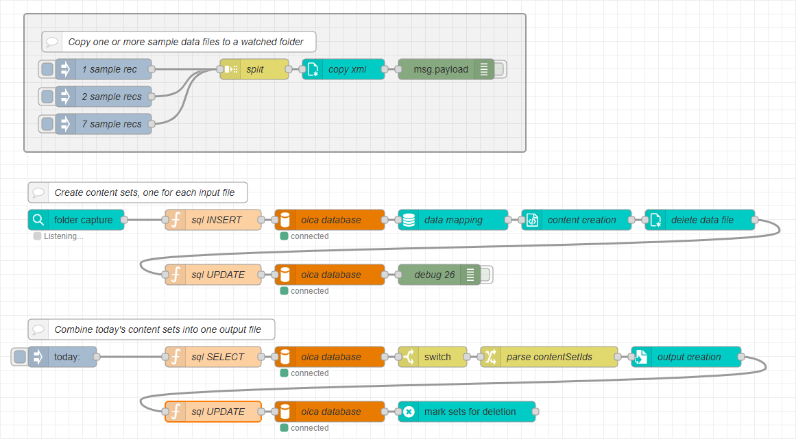

There are three flows, each serving a specific role in the daily set process.
Sample Data Injection flow
This flow uses the sample data injection technique described in the Automate sample data testing tutorial. It allows you to easily test different data files directly from the Flow Editor, without manually copying files into the watched or hot folder.
Job Submission flow
This flow begins with a folder capture node that processes any incoming XML file. It also receives jobs submitted by the sample data injection flow. In a production environment, these jobs would typically be created by an external system such as a CRM or order management platform.
The flow records job information in the external database and generates personalized content for each individual document.
Job Collection flow
Typically triggered on a scheduled interval, for example, at the end of the day or the following morning, this flow retrieves the generated jobs from the database and combines their output into a single consolidated file.
The three flows described above. Each flow is explained in detail on subsequent pages.
