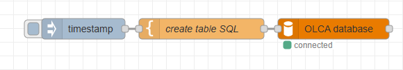

Creating the table using a flow
You can also create the table directly from within flow editor instead of using an external SQL tool. Follow these steps:
  1. Add an inject node to the canvas. This is used to trigger the flow manually.
  2. Add a template node, double click to enter its Properties, and set its Property field to msg.topic.
  3. Paste the SQL CREATE TABLE statement into the template node’s content.
  4. Add the mysql node to the flow, and double click to enter its Properties.
    • If you have not already installed this node, go to Menu > Manage Palette, Palette, Install,, search for node-red-node-mysql, and install the mysql node.
  5. For Database, click the plus sign, +, to add a new database. This opens another Properties panel.
  6. Enter the Host, Port, Username, Password, and Database (schema) name for the database.
A flow consisting of the input (timestamp), create table node, and a connected database.
The mysql node executes any SQL query provided through the msg.topic property.
In this setup, the template node injects the SQL command into msg.topic, enabling the mysql node to create the table when you manually trigger the inject node.
