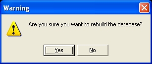

  3. In OL Connect Search, choose Options | Rebuild Database.
    OL Connect Search prompts you to confirm the rebuild.
  4. Click Yes to confirm.
