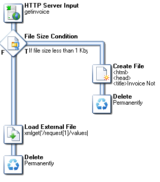

Process Illustration
Task Breakdown
  • The HTTP Server Input task receives a request through the /getinvoice HTTP Action. Because this task either returns an HTML page with an error message or a PDF, the MIME type is Auto-Detect.
  • It checks whether the invoice request exists by checking if the size of the file is less than 1kb using File Size Condition. The condition returns "true" if the file is not found:
    c:\PlanetPress\archives\pdf\invoices\xmlget('/request[1]/values[1]/invoicenum[1]',Value,KeepCase,NoTrim).pdf
    Here, the xmlget() function grabs the invoicenum variable from the GET request, which would be INV999999.pdf in the specified folder.
  • If the file is not found, then a simple, basic HTML page is created indicating the invoice was not found. For this, a Create File task will suffice, followed by the Delete output task. As we've already mentioned in HTTP Server Workflow, deleting the data file only means you are not doing anything with it locally - it is still returned to the client.
  • If, however, the file is found, then it is loaded with the Load External File task, and then deleted (for the same reasons).
