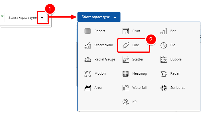

4. Select a Report Type
- Click the arrow button next to Select report type.
- Select your Line from the list of available report types to get started.

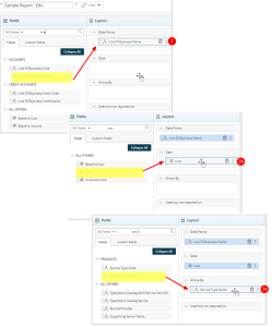

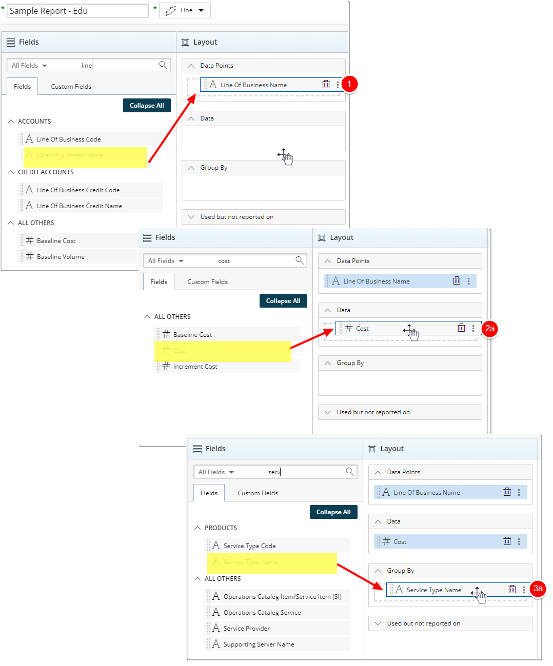

7. Select your Data Field(s)
- The Data Points section defines the X-Axis Data Set in your Graph. Drop one non-numeric Field to define the different points that will conform your line(s), in relation to your data set on the Y-Axis.
- The Data section defines the Y-Axis Data Set in your Graph. Drop the numeric Fields that will define the values on the Y-Axis (vertically), in relation to your Data Points.
- In the Group by section, drop one non-numeric Field to define the main category on the X-Axis (horizontally).

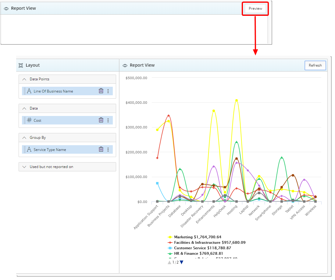

10. Preview Report
- Click the Preview button to preview your report.
