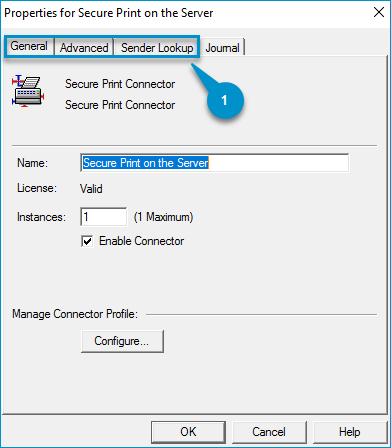

1. Secure Print Connector Properties dialog box
Use to set up the Secure Print Connector (SPC).
  • General tab
    • Specify or modify SPC name.
    • View or modify SPC license instances.
    • Enable or disable SPC connector.
  • Advanced tab
    • Specify or modify SPC folder to scan.
    • Specify or modify  SPC lookup failure email address.
  • Sender Lookup tab
    • Specify or modify SPC connection and search sender lookup parameters.

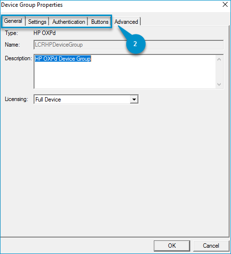

2. Device Group Properties dialog box
Use to set up Device Group with MyPrints button.
  • General tab
    • Specify or modify name, description, licensing and attribute map type default parameters.
  • Settings tab
    • Specify or modify Application, Web API, Ops Server, and Timeout default parameters.
  • Authentication tab
    • Specify or modify authentication type and LDAP lookup defaultt settings.
  • Buttons tab
    • Specify or modify MyPrints button and job properties.

Secure Print connector
To access the Secure Print connector
  1. Start the Server Administrator.
  2. Expand the Server Administrator tree, if necessary.
  3. Select Connectors.
  4. Right-click Secure Print on the Server in the details pane. The Properties shortcut menu appear.
  5. Select Properties.
  6. Use the Secure Print on the Server Properties dialog box to modify Secure Print on the Server properties.
Device group > MyPrints button
To access Devices
  3. Select and expand Devices, if necessary.
  4. Right-click the device group with the MyPrints button in the details pane. The Properties shortcut menu appears.
  6. Use the Device Group Properties dialog box to modify the device group with MyPrints button properties.
