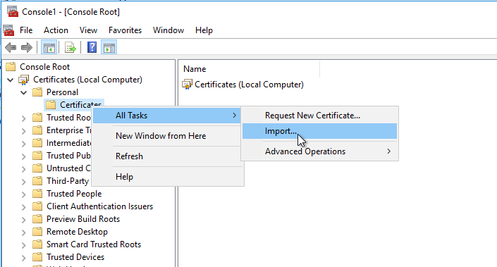

- Add the certificate in the Windows Certificate Manager:
- Launch the Microsoft Management Console: Start > Run > MMC.
- In the Management Console, go to File > Add/Remove Snap-in.
- Select the Certificates add-in.
- Choose Local Computer when prompted for which computer to manage certificates for while adding the certificate snap-in.
- When the certificate manager load, in the left navigation, expand Certificates (Local Computer) > Personal.
- Right-click the Certificates folder under Personal. Select All Tasks then Import.
- Follow the wizard to import your certificate.

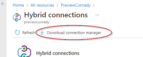

- Download the connection manager from the Azure Portal UI to your Hybrid Server.
- You can find the download link while viewing/configuring the Hybrid Connections in your App Service.

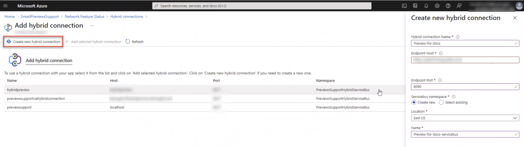

- Go to Networking → Hybrid Connections → Configure your hybrid connection endpoints
- Click Add hybrid connection.
- Fill out the hybrid connection info:
- Name - Name as desired.
- Example: SmartPreviewsHybrid
- Endpoint Host - The host of the Hybrid Service Site.
- Example: hybridpreview.contoso.com
- Endpoint Port - The port of the Hybrid Service Site.
- Example: 6677
- Servicebus Namespace - The underlying Service bus namespace used by the hybrid connection.
- Create a new one and name as desired.
- Example: SmartPreviewsServicebus
- Important! - The Endpoint provided above must resolve correctly on the Hybrid Server and must load the Hybrid Site.
Using the above examples, accessing https://hybridpreview.contoso.com:6677/pages/configure.aspx from the Hybrid Server virtual machine browser must correctly load the Hybrid Service configuration page.
This address must not be exposed to internet, therefore not publicly available.
- Click Ok to create the hybrid connection and wait for the creation process to complete.
