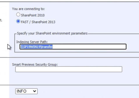

  • On your Smart Previews Settings page:
    • Record the path of your current transfer folder.
    • Note the example below:

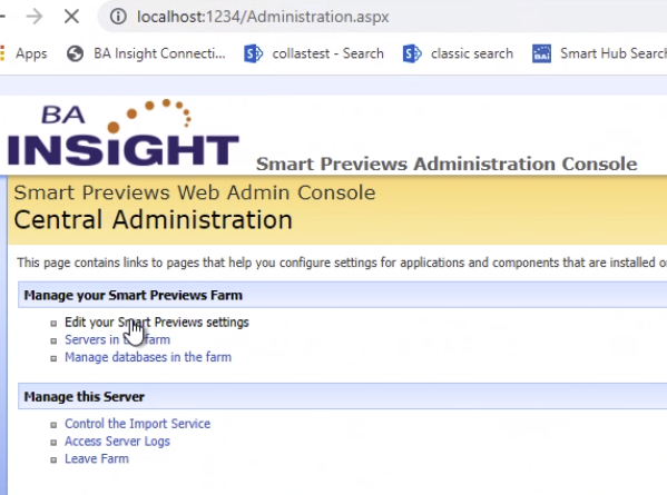

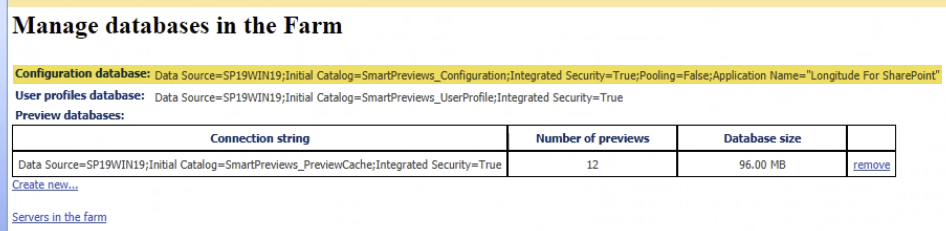

Collection Database String
  • Under Manage databases in the farm:Record the "Configuration database" string.

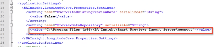

PreviewDataRepository Value
  1. Navigate to the directory <SmartPreviews_Install_root>/Previews Components/Previews CEWS/.
  2. Open the file CewsWindows.exe.config and note the "PreviewDataRepository" value:

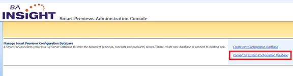

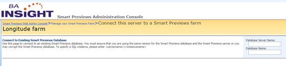

  1. Go to Smart Previews Web Admin Console site from IIS Manager and select Connect to existing Configuration Database.
  2. Provide the Database Server Name and the Database Name.
    Note: If it is required, upgrade the database.

  4. Locate the applicationSettings\BAInsight.LongitudeCews.Properties.Settings\PreviewDataRepositoryand replace %LocalLow% with the path of the BA-Insight Fast Proxy Incoming folder.

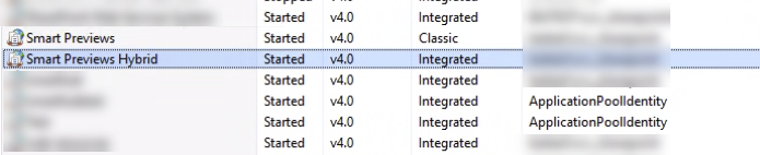

    1. In IIS, click Application Pools
    2. In the Application Pools list, note the domain\username value in the Identity column of your Smart Preview Hybrid site.

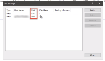

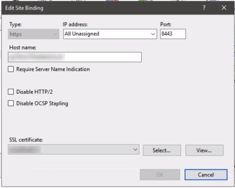

    3. In IIS Click Sites > Smart Previews Hybrid site.
    4. Click Bindings in the Actions panel.
    5.  Note the values for the Port and Host Name columns for your bindings.
    6. Click on your bindings, then select Edit
    7. Note the SSL certificate used for the hybrid site (blurred out below):

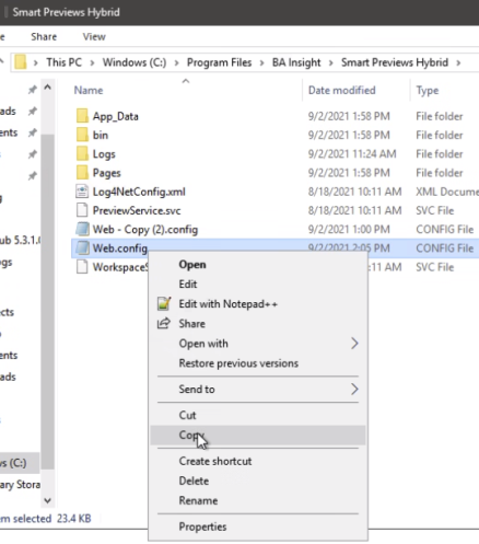

  3. Navigate to your Smart Previews Hybrid installation folder.
  4. Make a copy of your existing Web.config file.
  5. Navigate to the App_Data folder in your Smart Previews Hybrid installation folder.
  6. Make a copy of your existing FetcherConfiguration.xml file. After re-installation, follow the steps in Migrate your previous file information.

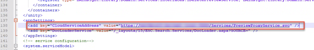

    DO NOT reuse your old web.config file when doing a product update or upgrade. The new web.config file contains new information.Existing web.config settings can be preserved by using the following steps:
    1. Open your existing web.config file
    2. Open the new web.config file
    3. In your existing web.config file, copy your (modified from original) settings.
    4. Overwrite the CloudServiceAddress (around line 138) with the value from your old web.config file copy.

  3. Locate the section appSettings\CloudServiceAddress.
    1. Replace the sample server address with your Smart Previews Web Resources URL, including the port number.
    2. You must include the path …./Services/PreviewProxyService.svc in your edited URL.
    3. Example:
      1. Defaulthttps://previewapp.bainsight.com/Services/PreviewProxyService.svc
      2. After editinghttps://webresources:4321/Services/PreviewProxyService.svc

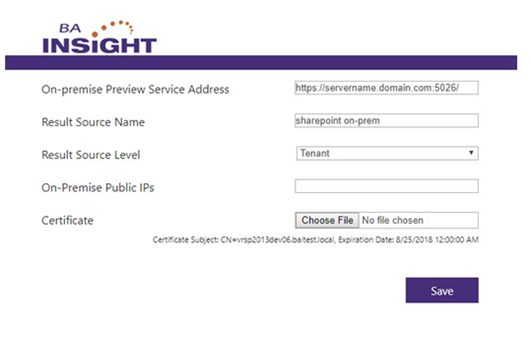

  4. Navigate to the Configuration page for Smart Previews Hybrid site: https://[SmartPreviewsAddress]/Pages/Configure.aspx
  5. Complete the fields on the page with the information from the following table:

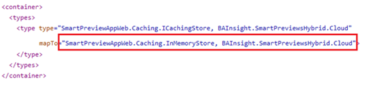

  2. Locate the unity\containers\container\types\type section.
    1. Change the mapping to: SmartPreviewAppWeb.Caching.InMemoryStore, BAInsight.SmartPreviewsHybrid.Cloud
  3. Change the map to parameter as follows:
       From: SmartPreviewAppWeb.Caching.RedisStore, BAInsight.SmartPreviewsHybrid.Cloud
       To: SmartPreviewAppWeb.Caching.InMemoryStore, BAInsight.SmartPreviewsHybrid.Cloud

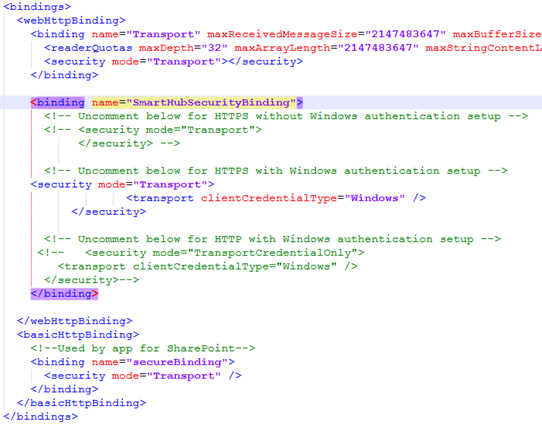

  4. Smart Previews Web Resources site must be configured to reference the SmartHub URL that is accessible from the server where the Smart Previews Web Resources are being installed.
    1. Open the web.config file.
    2. Locate the appsettings\SmartHubAddress section and change the address to match your SmartHub URL using this format: https://contoso.com
    3. Locate the appsettings\SetupModesection and change the value to SmartHub.
    4. Locate the system.serviceModel\bindings\webHttpBinding section and change the SmartHubSecurityBinding by uncommenting the SmartHub security section and commenting the other two sections.
  5. Navigate to the Configure page for Smart Previews Web Resources: https://[SmartPreviewsWebResourcesAddress]/Pages/Configure.aspx
Enter the information that is required to establish the connection with the SharePoint 2013/2016/19 component:
  1. On-premise Preview Service Address: Enter the Smart Previews Hybrid site address followed by the port where the Smart Previews Hybrid site is running.
  2. Result Source Name: Enter the local SharePoint results source name, which you created to return local results.
    1. The result source name is required to execute valid queries in order to confirm the rights of the current user who is requesting the Preview.
    2. The default value is Local SharePoint Results.
  3. Result Source Level: Specify, or leave the default value "Tenant".
  4. Certificate: Upload the .CER file.

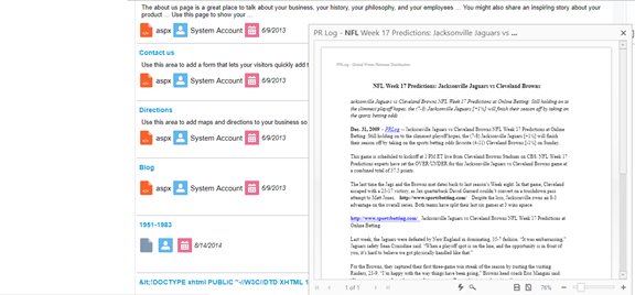

Validate Your Upgrade
Go to your search center and run a query to see the documents that have kept the generated previews.
Verify your previews.
