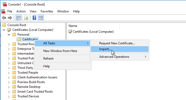

  2. Add the certificate in the Windows Certificate Manager:
    1. Launch the Microsoft Management Console: Start > Run > MMC.
    2. In the Management Console, go to File > Add/Remove Snap-in.
    3. Select the Certificates add-in.
      1. Choose Local Computer when prompted for which computer to manage certificates for while adding the certificate snap-in.
      2. When the certificate manager load, in the left navigation, expand Certificates (Local Computer) > Personal.
      3. Right-click the Certificates folder under Personal. Select All Tasks then Import.
      4. Follow the wizard to import your certificate.

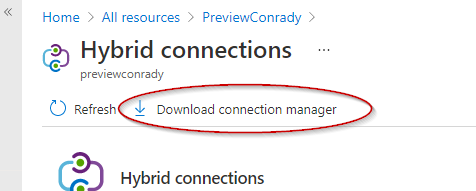

  3. Download the connection manager from the Azure Portal UI to your Hybrid Server.
    1. You can find the download link while viewing/configuring the Hybrid Connections in your App Service.

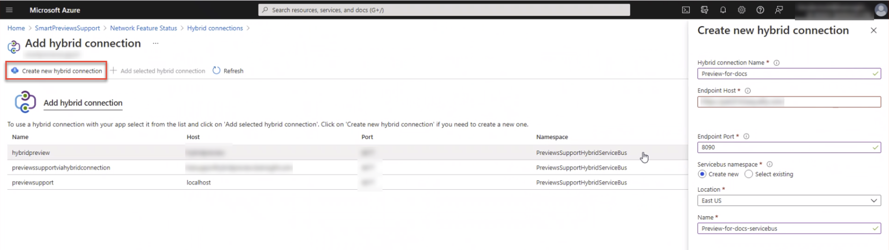

  5. Go to Networking Hybrid Connections Configure your hybrid connection endpoints
  6. Click Add hybrid connection.
  7. Fill out the hybrid connection info:
    1. Name - Name as desired.
      1. Example: SmartPreviewsHybrid
    2. Endpoint Host - The host of the Hybrid Service Site.
      1. Example: hybridpreview.contoso.com
    3. Endpoint Port - The port of the Hybrid Service Site.
      1. Example: 6677
    4. Servicebus Namespace - The underlying Service bus namespace used by the hybrid connection.
      1. Create a new one and name as desired.
      2. Example: SmartPreviewsServicebus
      3. Important! - The Endpoint provided above must resolve correctly on the Hybrid Server and must load the Hybrid Site.
        Using the above examples, accessing https://hybridpreview.contoso.com:6677/pages/configure.aspx from the Hybrid Server virtual machine browser must correctly load the Hybrid Service configuration page.
        This address must not be exposed to internet, therefore not publicly available.
  8. Click Ok to create the hybrid connection and wait for the creation process to complete.
