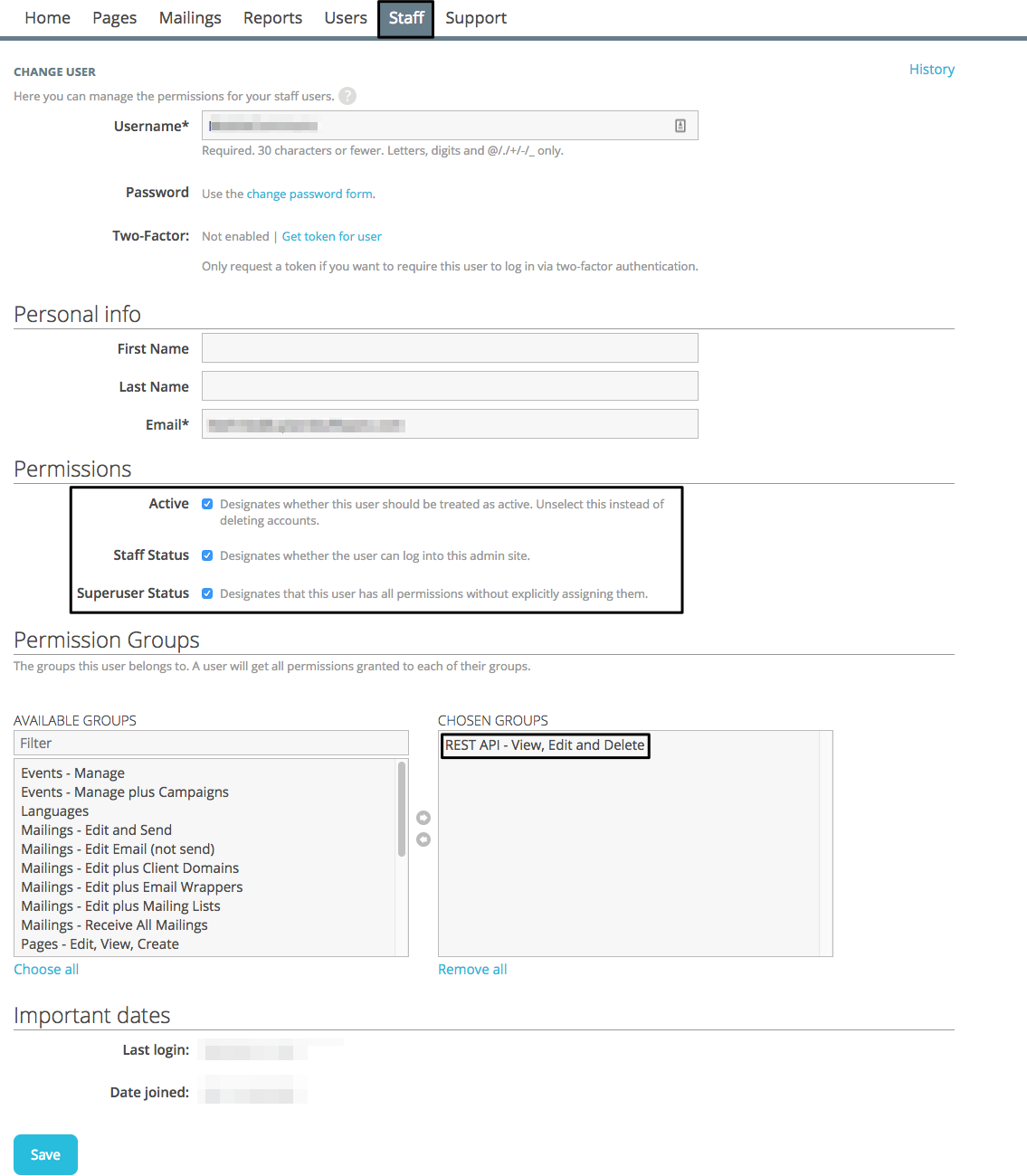

Tip: Create a new set of credentials exclusively for use with Mobile Commons (recommended).
To set up new API credentials, use the following Permissions and Chosen Groups settings in ActionKit:
Note: Make sure that the API user has Superuser status.
Make a note of the API host name, which is usually the URL of your ActionKit account.

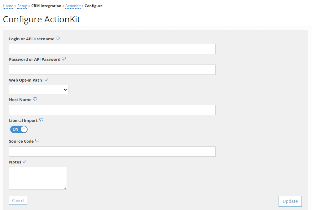

Configuring the ActionKit integration
To sync data between your ActionKit database and Mobile Commons:
Select
Home in the left pane, and then select Data Sync. -
From the Integration Type drop-down list, select ActionKit.
Select Create.
The ActionKit configuration form opens.
For assistance, select
Help next to the field label. -
In the Login field, enter your user name for your ActionKit system, and then enter your password in the Password field.
(Optional) If users from ActionKit will opt-in to your campaign via a web path opt-in, select the Mobile Commons web opt-in path from the drop-down list. New mobile users from ActionKit will receive opt-in messages from the opt-in path you specify.
Enter the host name for API requests.
Select the type of data sync:
Select On to enable Liberal data sync: sync data in both directions, regardless of the opt-in status.
Select Off to disable Liberal data sync (Conservative sync): sync data only for those records with an opt-in status of true in your ActionKit system.
Enter the source code identifying Mobile Commons to your ActionKit system. The default entry is Mobile Commons.
(Optional) Enter your notes for internal use only.
When you are done, select Update.

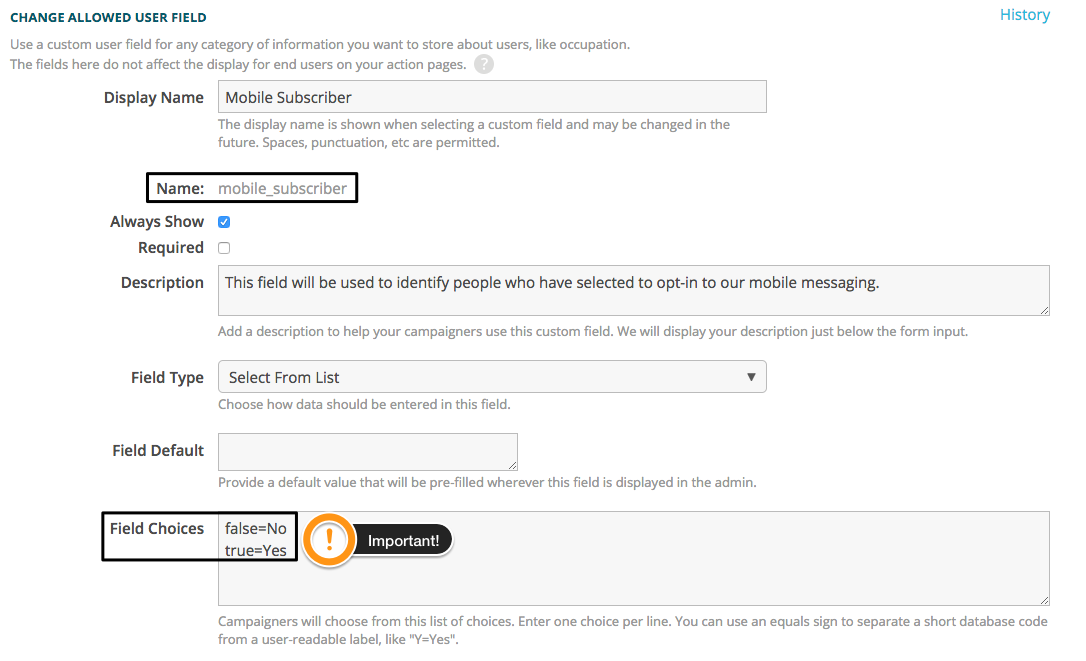

Setting up a subscriber field in ActionKit
In order to sync opt-in status, you'll need to add a subscriber field in ActionKit.
To set up a subscriber field:
Log in to your ActionKit system.
From the ActionKit Tools page, select the Users tab.
Select Add allowed user field.
(Required) In the Display Name field, enter Mobile Subscriber.
Note: The Name field is filled in automatically. This is the field name you will specify when you set up the field mappings. For more information, see Reviewing required and supported fields.
Select the Always Show checkbox.
(IMPORTANT) Leave the Required checkbox blank.
Enter a brief description in the Description field.
Leave the Field Type field blank.
(IMPORTANT) In the Field Choices field, enter the following:
false=No
true=Yes
When you are done, select Save.

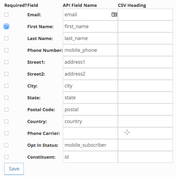

If you are not using the default field names, use custom field mappings to specify field names in ActionKit.
To set up custom field mappings:
Select
Home in the left pane, and then select Data Sync.The home page for your ActionKit sync opens.
In the Integration Actions panel on the right, select Edit Field Mappings.
Review the field names to ensure that they are correct.
The Field column contains the Mobile Commons field name.
The API Field Name column contains the API field name in ActionKit.
To limit the sync to records that contain data in specific fields, select the Required? checkbox next to the field name. When a field is required, it must contain a value in order to be synced. Empty fields are not synced.
Caution: Do not select Required for Phone number, Email, or Opt-in status fields, which must by default exist in both databases in order to sync data. Use caution if you change the field name for any of these three fields; if the custom field name is incorrect, the data sync will fail.
Caution: Do not select Required for Constituent as this ID is provided by ActionKit. If it is set to Required, Mobile Commons profiles will not have this ID, causing the sync from Mobile Commons to ActionKit to fail.
