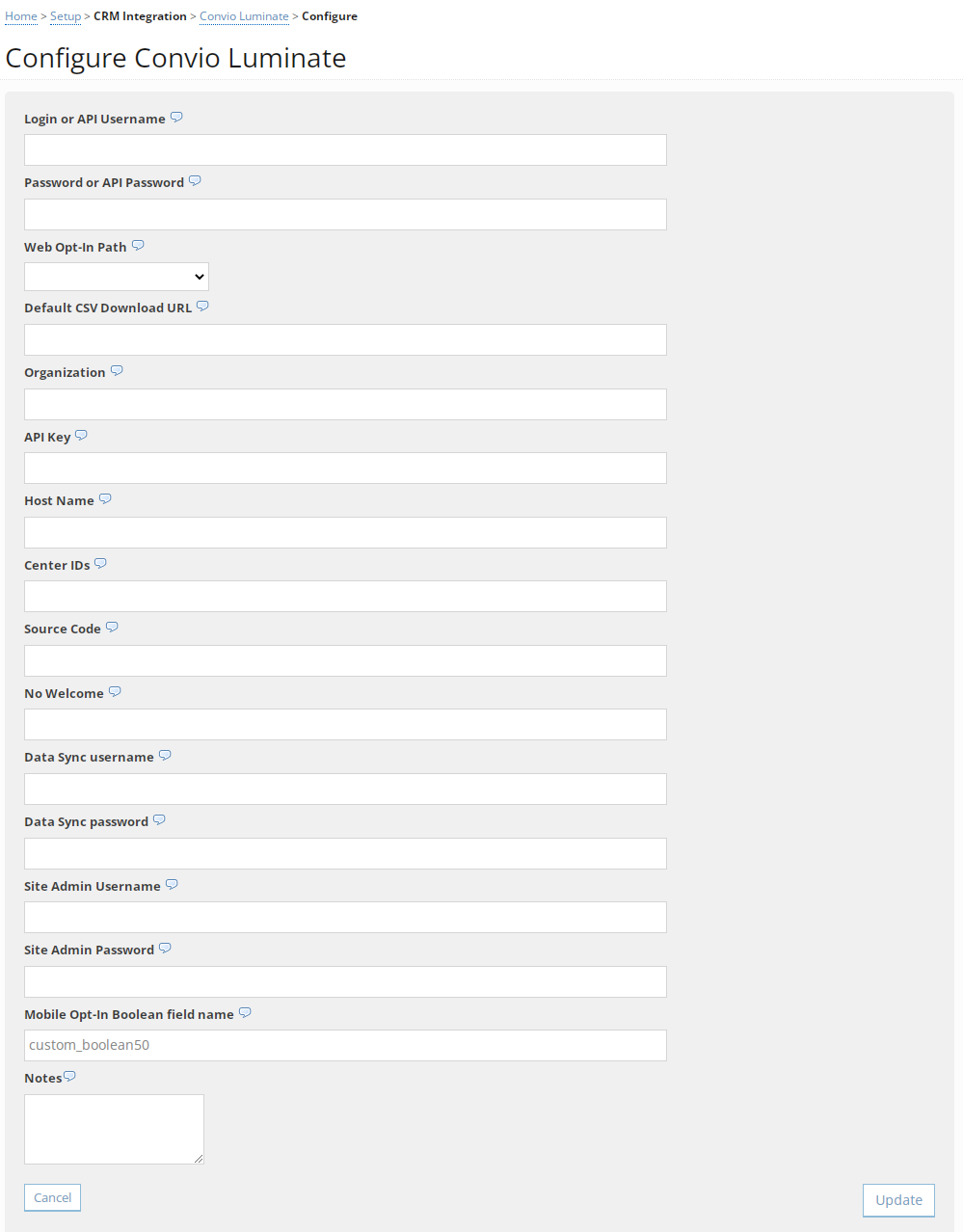

Configuring the Convio Luminate integration
To sync data between your Convio Luminate database and Mobile Commons:
Select
Home in the left pane, and then select Data Sync. -
From the Integration Type drop-down list, select Convio Luminate.
Select Create.
The Convio Luminate configuration form opens.
For assistance, select
Help next to the field label. -
In the Login field, enter your user name for your Convio Luminate system, and then enter your password in the Password field.
(Optional) If users from Convio Luminate will opt-in to your campaign via a web path opt-in, select the Mobile Commons web opt-in path from the drop-down list. All mobile users from Convio Luminate will receive opt-in messages from the opt-in path you specify.
Enter the default URL for the CSV (comma-separated values) export file that will be downloaded nightly from Convio Luminate.
Enter the Convio organization code.
Tip: The organization code is usually found in the Convio URL.
Enter the API key for the web service.
Enter the host name for API requests.
In the Center IDs field, list one or more Convio centers to include in the sync. Separate multiple centers with a , (comma); leave the field blank if the sync will not involve a specific center.
Enter the source code identifying Mobile Commons to your Convio Luminate system. The default entry is mcommons.
To specify the setting for sending or suppressing a Welcome email message for new subscribers:
Leave the field blank to send a Welcome message to new subscribers, if that feature is enabled in the Convio Luminate settings.
Enter 1 (one) to set the No_Welcome field to 1. Your Convio Luminate settings will determine whether or not the email is sent.
In the Data Sync user name field, enter your user name to log in to the FTP site, and then enter your password in the Data Sync password field.
In the Site Admin user name field, enter your user name to log in to the Convio center, and then enter your password in the Site Admin password field.
In the Mobile opt-in Boolean field name field, enter the name of the Convio checkbox field that identifies the constituent as a Mobile Commons subscriber.
(Optional) Enter your notes for internal use only.
When you are done, select Update.
Note: To help the Mobile Commons team validate the sync from Convio Luminate to Mobile Commons, send them a web form that would generate test users on Convio. Be sure to include a the Mobile Number field and, if they are testing a Conservative sync, a Mobile Opt in field.
