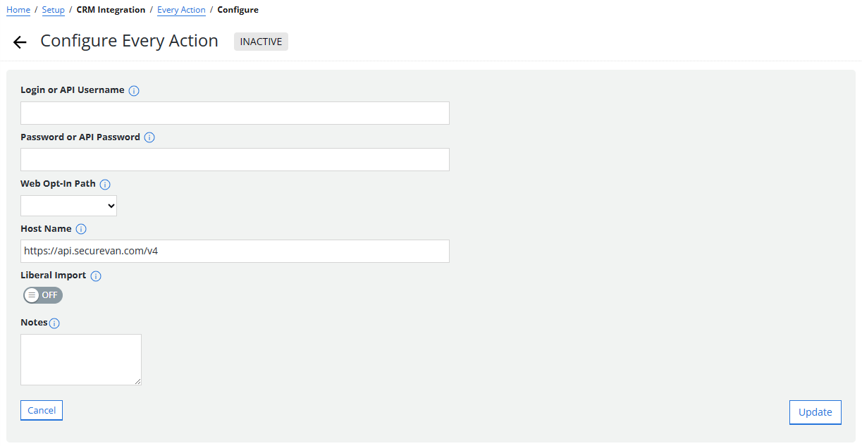

Configuring the EveryAction integration
To sync data between your EveryAction database and Mobile Commons:
Select
Home in the left pane, and then select Data Sync. -
From the Integration Type drop-down list, select EveryAction.
Select Create.
The EveryAction configuration form opens.
For assistance, select
Help next to the field label. -
In the Login field, enter your user name for your EveryAction system, and then enter your password in the Password field.
(Optional) If users from EveryAction will opt-in to your campaign via a web path opt-in, select the Mobile Commons web opt-in path from the drop-down list. All mobile users from EveryAction will receive opt-in messages from the opt-in path you specify.
Enter the host name for API requests.
Select the type of data sync:
Select On to enable Liberal data sync: sync data in both directions, regardless of the opt-in status.
Select Off to disable Liberal data sync (Conservative sync): sync data only for those records with an opt-in status of true in your EveryAction system.
(Optional) Enter your notes for internal use only.
When you are done, select Update.

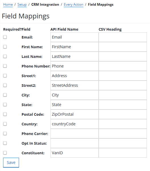

Use custom field mappings to specify field names in EveryAction.
To set up custom field mappings:
Select
Home in the left pane, and then select Data Sync.The home page for your EveryAction sync opens.
In the Integration Actions panel on the right, select Edit Field Mappings.
Review the field names to ensure that they are correct.
The Field column contains the Mobile Commons field name.
The API Field Name column contains the API field name in EveryAction.
To limit the sync to records that contain data in specific fields, select the Required? checkbox next to the field name. When a field is required, it must contain a value in order to be synced. Empty fields are not synced.
Caution: Do not select Required for Phone number, Email, or Opt-in status fields, which must by default exist in both databases in order to sync data. Use caution if you change the field name for any of these three fields; if the custom field name is incorrect, the data sync will fail.
Caution: Do not select Required for Constituent as this ID is provided by EveryAction. If it is set to Required, Mobile Commons profiles will not have this ID, causing the sync from Mobile Commons to EveryAction to fail.
When you are done, select Save.
