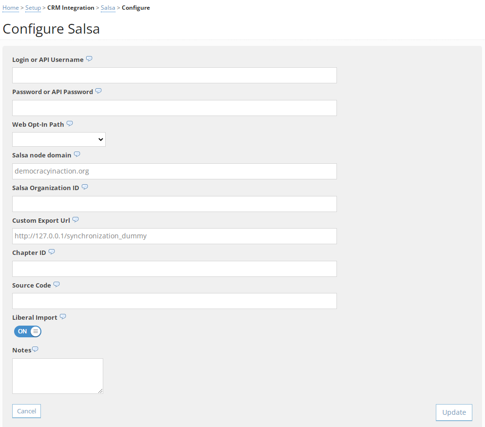

Configuring the Salsa integration
To sync data between your Salsa database and Mobile Commons:
Select
Home in the left pane, and then select Data Sync. -
From the Integration Type drop-down list, select Salsa.
Select Create.
The Salsa configuration form opens.
For assistance, select
Help next to the field label. -
In the Login field, enter your user name for your Salsa system, and then enter your password in the Password field.
(Optional) If users from Salsa will opt-in to your campaign via a web path opt-in, select the Mobile Commons web opt-in path from the drop-down list. New mobile users from Salsa will receive opt-in messages from the opt-in path you specify.
In the Salsa node domain field, enter the host name for your Salsa node.
Enter your Salsa organization ID.
(Optional) If you are configuring a Conservative sync, in the custom export URL field, enter the full URL of the Salsa custom report. For more information, see Building a custom report.
Enter the chapter ID for your organization, if available.
Enter the source code identifying Mobile Commons to your Salsa system. The default entry is Mobile Commons.
Select the type of data sync:
Select On to enable Liberal data sync: sync data in both directions, regardless of the opt-in status.
Select Off to disable Liberal data sync (Conservative sync): sync data only for those records with an opt-in status of true in your Salsa system.
(Optional) Enter your notes for internal use only.
When you are done, select Update.
Tip: To test your configuration, supply your Mobile Commons team with a web form that we can use to generate test users in Salsa and validate the data sync from Salsa to Mobile Commons.
