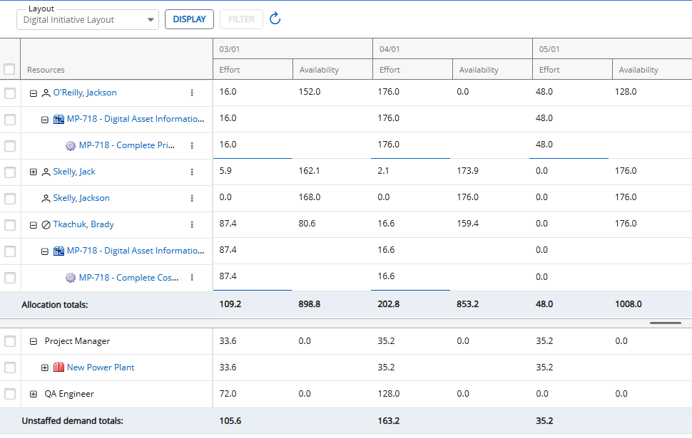

The Resource Review page provides a centralized view of Resource allocation (effort) and availability across work items, as well as any unstaffed demand that currently exists. It helps users make informed decisions about staffing, workload balancing, and capacity planning.
Note: The 2025R1.0 version of PowerSteering introduced the first phase of a new Resource Review interface, which is pictured above. It can be accessed by selecting Review → Resource Review (New) from the Navigation Menu.
This current phase of the new interface does not enable users to add filters to their Resource Review Layouts; an upcoming release will implement filtering into the new page.
If you would like to add filters to a Resource Review Layout, you will need to select the layout from the Navigation Menu and add filters. After that, you can view the updated layout on the new Resource Review page.

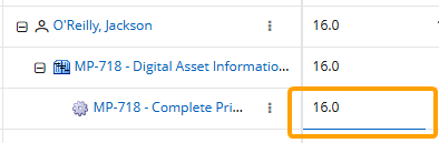

The Allocation section (top section) displays PowerSteering Resources, as well as their current assignments ("Effort") and available time ("Availability"). Resource effort can be edited from the Resource Review page on the work item that the Resource was directly assigned to. Editable cells are indicated by a blue underline.

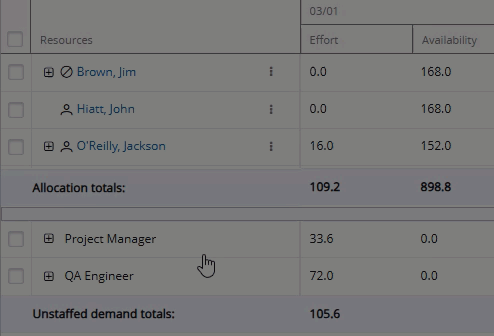

Tip: Drag and drop the gray dividing bar between the Allocation and Demand sections to change the size of each section.
Click thumbnail to play.

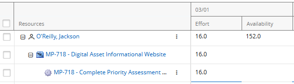

Example: Jackson O'Reilly has only been assigned to 16 hours of work in the month of March. He still has 152 available hours of work.
Expanding "O'Reilly, Jackson" reveals that all 16 of these hours have been allocated toward the "Complete Priority Assessment" work item that is part of the "Digital Asset Informational Website" Gated Project.
The "Effort" cell contains a blue underline, which means it can be updated directly from the Resource Review page.

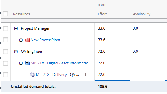

The Demand section

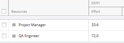

The Demand section (bottom section) lists the current demand for Resources on PowerSteering work items.
In PowerSteering, "demand" refers to unstaffed positions on work items. It occurs when a Role has been assigned to a work item, but no Resource.

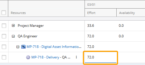

In this example from Project Central, the "QA Engineer" Role has been selected for the "Delivery" work item. However, no Resource has been added to the "Assignments" column. This results in unstaffed demand for the Role of "QA Engineer" on the work item.
Demand effort can be edited on the Resource Review page for work items that directly contain it. Editable cells are indicated by a blue underline.

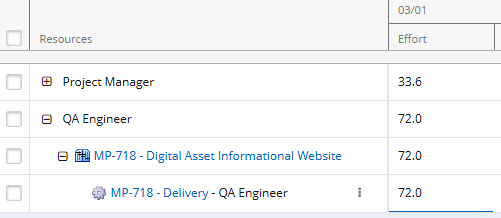

Example: According to the Resource Review page, there are 72 hours of unstaffed demand for the "QA Engineer" Role in the month of March.
Expanding "QA Engineer" reveals that all 72 of these hours belong to the "Delivery" work item that is part of the "Digital Asset Informational Website" Gated Project.
The effort cell contains a blue underline, which means it can be updated directly from the Resource Review page.
Tip: The Resource Review Display settings can be configured to determine how demand data is arranged and presented on the page. Also, the Resource Review filters can be configured to determine which data is included on the page.
