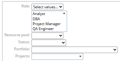

Role
Use the drop-down menu to determine which Roles will be included.
Note: Selecting the blank space will exclude all Roles, which will filter out all unstaffed demand from the Resource Review page and cause the Demand section to disappear.
Any value: Unstaffed demand for all Roles will be included.
Select values...: Select which Roles will be included. Only unstaffed demand from the selected Roles will be included in the Demand section.

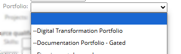

Portfolio
Use the drop-down menu to filter the unstaffed demand by Portfolios. Only unstaffed demand that belongs to work items of the selected Portfolio will be included.
Note: This filter applies to both the work item that the unstaffed demand is directly assigned to and its displayed parent work.
