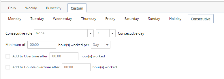

  9. The Daily, Weekly, Bi-Weekly and Custom tabs outline, for different period types, how and when hours are to be added to Overtime or Double overtime. For further details refer to:
    1. Processing Overtime: Daily, Weekly, Bi-Weekly Rules
    2. Processing Overtime: Custom Day / Holiday Rules
    3. Processing Overtime: Custom Consecutive Accumulation Rules

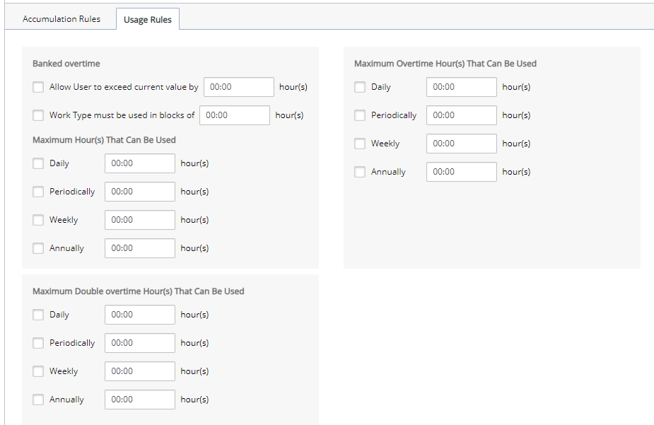

  10. Select the Usage Rules tab to define how any earned overtime is to be used as banked overtime. These rules govern how any earned overtime is to be used as banked overtime, i.e., for overtime not paid, but rather exchanged later for time off. For further details refer to Processing Overtime: Usage Rules tab.
