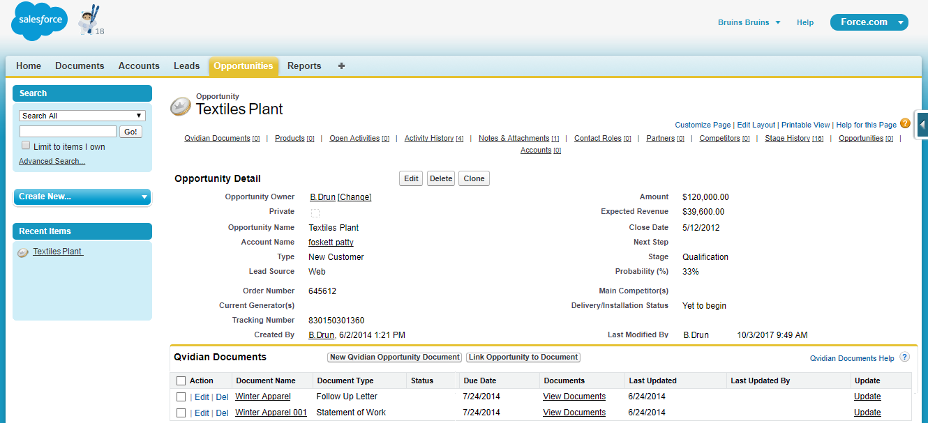

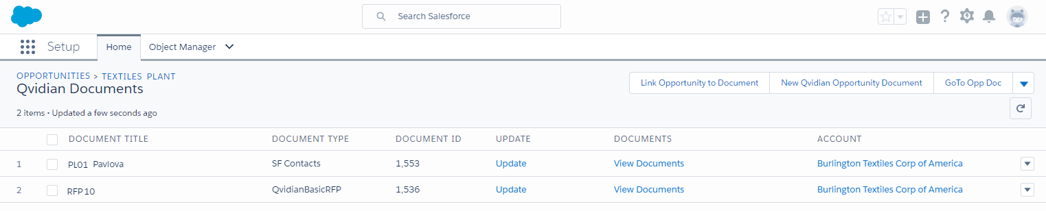

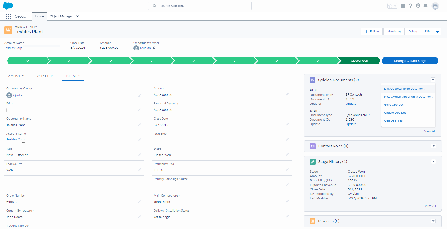

Examples of a Salesforce Lightning Opportunity page with the Qvidian Documents panel on the left (left), and a Salesforce Aloha Opportunity page with the Qvidian Documents panel on the bottom (right). Click to enlarge.

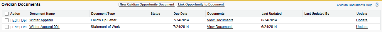

Examples of Upland Qvidian documents in Salesforce.com Lightning(left) and Classic (right). Click to enlarge.
In the Qvidian Documents panel in an Opportunity, do one of the following:
- Salesforce Classic: Click the New Qvidian Opportunity Document button.
- Salesforce Lightning: From the Qvidian Documents drop-down menu, select New Qvidian Opportunity Document, or click Qvidian Documents to open the Qvidian Documents page and then click the New Qvidian Opportunity Document.

Linked documents created in Upland Qvidian are listed in the Qvidian Documents panel. In Salesforce Classic, all documents are listed in the panel. In Salesforce Lighting, only the top three are listed; you must click Qvidian Documents to open the Qvidian Documents page and view the complete list.

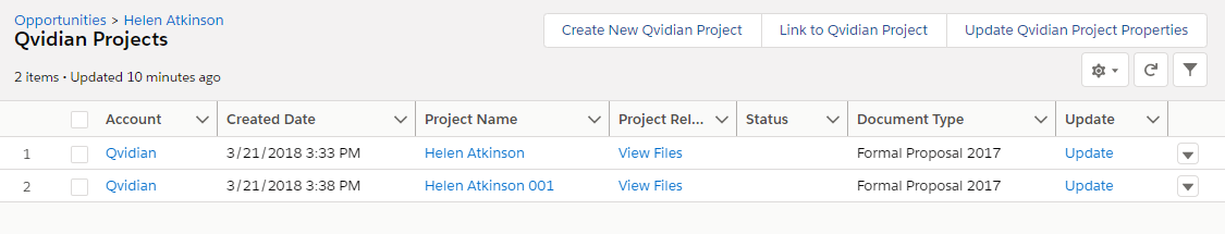

Examples of Upland Qvidian projects in Salesforce.com Lightning(left) and Classic (right). Click to enlarge.

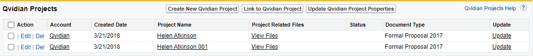

- In the Qvidian Projects panel in an Opportunity, do one of the following:
- Salesforce Classic: Click the Create New Qvidian Project button.
- Salesforce Lightning: From the Qvidian Projects drop-down menu, select Create New Qvidian Project, or click Qvidian Project to open the Qvidian Projects page and then click the Create New Qvidian Project.
- The My Work > Documents & Projects page opens in a new browser tab with the Create New dialog box open.
- Select Create a project.
- Fill out the remaining fields and create your project as you normally would.
