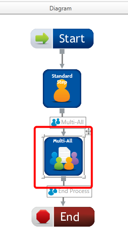

Available connections
The Multi-All step stencil has four connection points, one on each side of the stencil. These connection points are used to establish incoming and outgoing connections. There is no limit to the number of incoming or outgoing connections that can be established on a Multi-All step stencil.

  1. To access stencil properties, in the Diagram pane of the Workflow Designer, perform one of the following:
    • Double-click a Multi-All stencil.
    • Right-click a Multi-All stencil and select Properties.
    • Select a Multi-All stencil and press the F4 keyboard shortcut.
