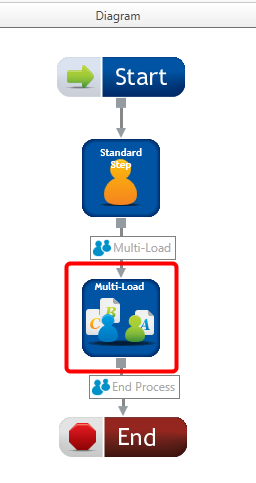

Multi-Load step
A Multi-Load step can be used to assign a document to a single user from a list of multiple users or group of users. The document will be assigned to the user with the least number of assignments in order to distribute the workload evenly among multiple users.
All assignments on all steps within a project are considered while calculating the number of assignments a user has.

Available connections
The Multi-Load Step stencil has four connection points, one on each side of the stencil. These connection points are used to establish incoming and outgoing connections. There is no limit to the number of incoming or outgoing connections that can be established on a Multi-Load Step stencil.

  1. To access stencil properties, in the Diagram pane of the Workflow Designer, perform one of the following:
    • Double-click a Multi-Load stencil.
    • Right-click a Multi-Load stencil and select Properties.
    • Select a Multi-Load stencil and press the F4 keyboard shortcut.
