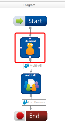

The Standard Step has four connection points, one on each side of the stencil. These connection points are used to establish incoming and outgoing connections. There is no limit to the number of incoming or outgoing connections that can be established on a Standard Step stencil.

  1. To access stencil properties, in the Diagram pane of the Workflow Designer, perform one of the following:
    • Double-click a Standard step stencil.
    • Right-click a Standard step stencil and select Properties.
    • Select a Standard step stencil and press the F4 keyboard shortcut.
