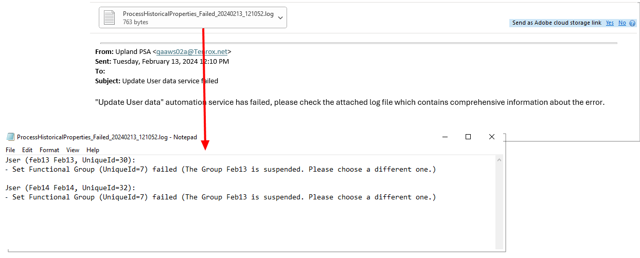

Should the Automation Service fail, an email message is sent to the email address defined for the Master Administrator user containing the following details:
Title: Process Historical Properties service failed.
Message: "Update User data" automation service has failed, please check the attached log file which contains comprehensive information about the error.
The attached log file includes the following information: User Name and failed ObjectName (each object will appear on a separate line).
Failure notification with attached log file
