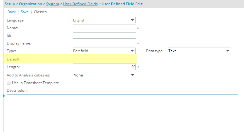

The Text option gives you the possibility to add user-defined fields as a text box where text can be entered.
Upon selecting to create a UDF of Type Edit Field and Data type Text, you have the option to specify a Default value for the Text box.
Note: It is not mandatory to enter a Default value for a Text Data type.

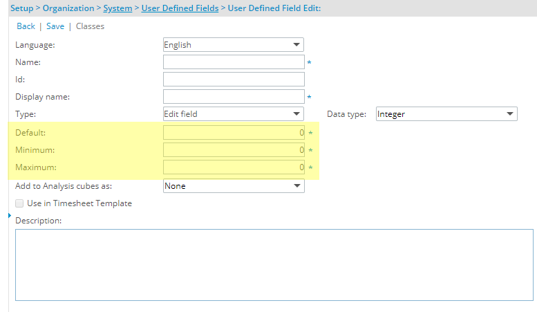

The Integer option gives you the possibility to add user-defined fields as a text box where an integer (no fractional part, and no digits after the decimal point) can be entered.
Upon selecting to create a UDF of Type Edit Field and Data type Integer, you must specify:
- A Default value for the Integer.
- A Minimum allowable value.
- A Maximum allowable value. By default, 2,147,483,647 is set as the Maximum value.
Note: It is mandatory to enter a Default, Minimum and Maximum values for an Integer Data type.

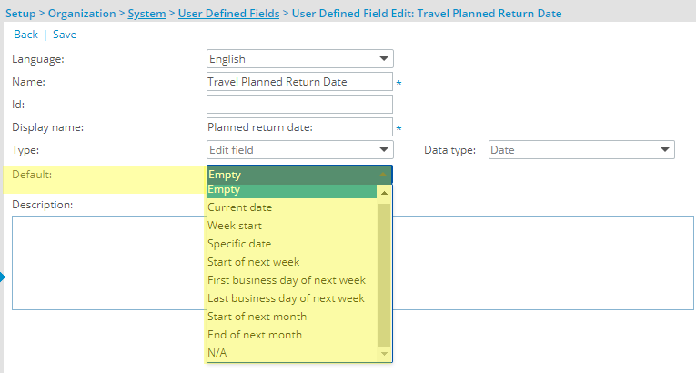

The Date option gives you the possibility to add user-defined fields as a Date format.
Upon selecting to create a UDF of Type Edit Field and Data type Date, you can specify what the Default value for the Date Field will be. The available options to choose from are:
- Empty
- Current date
- Week start
- Specific date
- Start of next week
- First business day of next week
- Last business day of next week
- Start of next month
- End of next month
- N/A
Note: It is not mandatory to enter a Default value for a Date Data type.

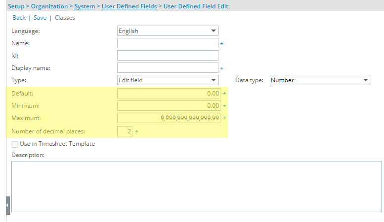

The Number option gives you the possibility to add user-defined fields as a text box where a number value can be entered.
Upon selecting to create a UDF of Type Edit Field and Data type Number, you must specify:
- A Default value for the Number.
- A Maximum allowable value. By default, 9,999,999,999,999.99 is set as the Maximum value.
- Number of decimal place By default, this value is set based on the Regional Settings of the logged User's Site. You can choose up to 8 decimal places.
Note: It is mandatory to enter a Default, Minimum and Maximum values for an Number Data type.

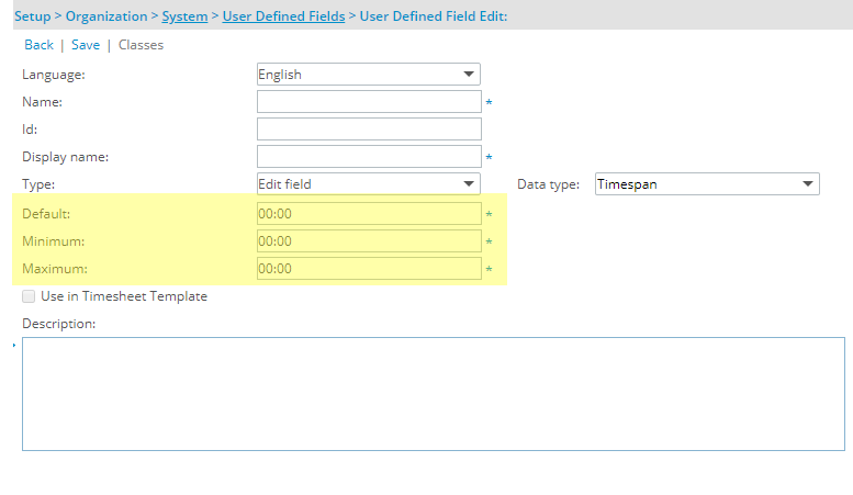

Upon selecting to create a UDF of Type Edit Field and Data type Timespan, you must specify:
- A Default value for the Timespan.
Note: It is mandatory to enter a Default, Minimum and Maximum values for an Timespan Data type.

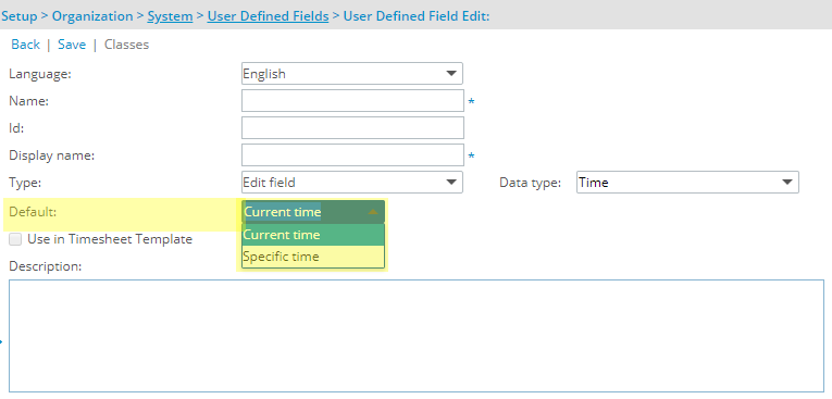

Upon selecting to create a UDF of Type Edit Field and Data type Time, you have the option to specify a Default value for the Time field. You can choose from one of the following options:
- Current Time
- Specific Time
Note: By default Current Time is selected for the Time Data type.

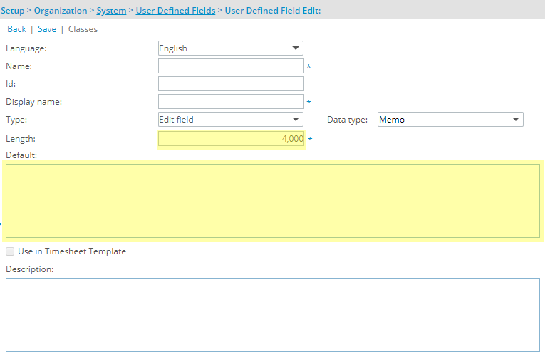

The Memo option gives you the possibility to add user-defined fields as a text area.
Upon selecting to create a UDF of Type Edit Field and Data type Memo, you have the option to specify:
- The Length of the Memo box.
- TheDefault value for the Memo box.
Note: It is mandatory to enter a Length value for the Memo box.

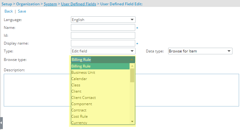

The Browse for Item option gives you the possibility to add user-defined fields as a browse field (...) or as a (pull-down) combo-box.
Upon selecting to create a UDF of Type Edit Field and Data type Browse for Item, you have the option to specify a Browse type from the list of available modules:
- Billing Rule
- Business Unit
- Calendar
- Client
Note: Suspended Clients can be selected in a Browse for Item custom User Defined Field.

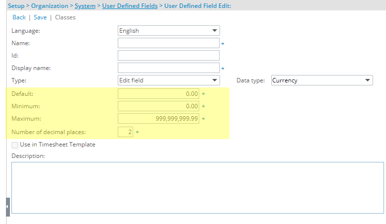

The Currency option gives you the possibility to add user-defined fields as text box where currency amounts can be entered.
Upon selecting to create a UDF of Type Edit Field and Data type Currency, you must specify:
- A Default amount.
- A Minimum allowable amount.
- A Maximum allowable amount. By default, 9,999,999,999,999.99 is set as the Maximum value.
- Number of decimal place. By default, this value is set based on the Regional Settings of the logged User's Site. You can choose up to 8 decimal places.
Note: It is mandatory to enter a Default, Minimum and Maximum values for an Currency Data type.

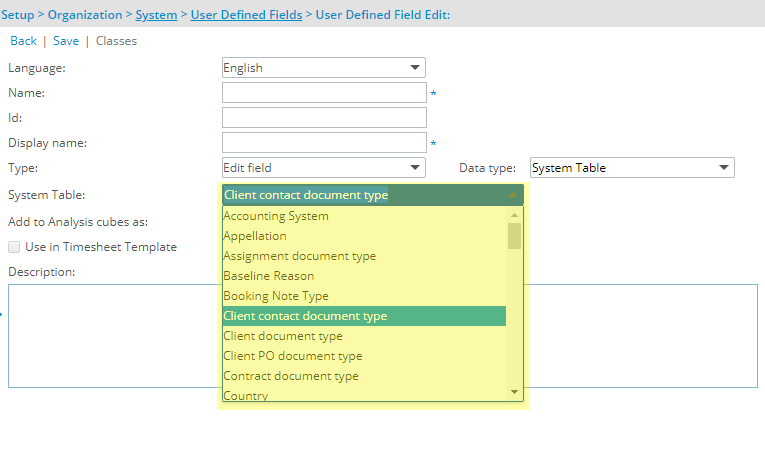

System tables contain a list of all selection (drop-down) lists existing in the application. System table is based on the fact that for certain fields, there are a fixed number of options to choose from, which apply across the organization's system.
Upon selecting to create a UDF of Type Edit Field and Data type System Table, you have the option to specify a System Table type from the list of available modules which includes:
which includes:
- Account types
- Accounting System
- Appellation
- Assignment document type
- Baseline Reason
- Booking Note Type
- Client contact document type
- Client document type
- Client Industry
- Client Ownership
- Client PO document type
- Client Rating
- Client Type
- Company Type
- Contract document type
- Country
- Date type selection
- Entertainment Purposes
- Equipment Units
- Expense entry document type
- Expense report document type
- Expense Sub type
- Expense type
- Format
- Marital
- Material Units
- Mileage scheme
- Milestone State
- Misc. Units
- Must Fund Reason
- Notes document type
- Payment terms
- PO Status
- Portfolio document type
- Portfolio Project Tab View Options
- Product Units
- Project document type
- Project Priority
- Project Status
- Project Type
- Purchase entry document type
- Purchase item document type
- Purchase Item States
- Purchase order document type
- Purchase Order Priority
- Purchase receipt document type
- Purpose list
- Requisition document type
- Role document type
- Role Type
- SAGE300 Accounting System Version
- Service Units
- Skill interest
- State
- Supplier contact document type
- Supply Units
- Task document type
- Task Priority
- Task State
- Time entry document type
- Timesheet document type
- Timesheet template PM Rejected
- Travel Units
- User document type
- User Note types
- User type
- Will buy a solution?
- Will choose our solution?
- Work Item Priority
- Work Item Probability
- Work Item Severity
- Work type document type
- Workflow document type
- Workflow type
Note: The available options may vary depending on the modules licensed.

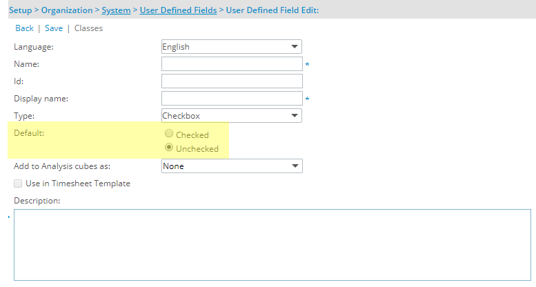

2. Checkbox
The Checkbox option gives you the possibility to add user-defined fields as a check box.
Upon selecting to create a UDF of Type Checkbox, you have the option to specify a Default value for the checkbox state.
Select one of the following options:
- Checked
- Unchecked
Note: By default Unchecked is selected.

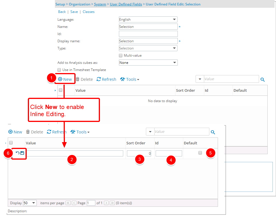

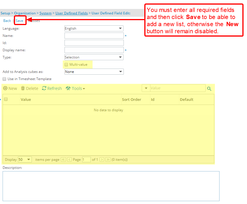

3. Selection
The Selection option gives you the possibility to add user-defined fields as selection list.
Selecting the Multi-value box enables users to select multiple values from the Selection list.
If you selected the Selection (drop-down list) type, then create a new list by following the steps in 3.1 below.
Note: You must enter all required fields and then click Save to be able to add a new Selection list.
- Click New.
- Enter the name of the selection in the Value field
- Enter a Sort Order.
- Enter an Id.
- If this selection should be displayed as a default entry, select the Default box.
- If this option should be temporarily unavailable, select Suspend.
- Click Save to save or Undo to undo your changes.
- Repeat steps 1-7 above to add more than one Selection option.

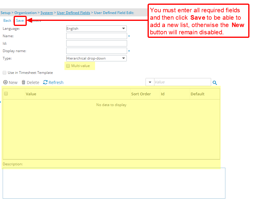

4. Hierarchical Drop-Down
The Hierarchical drop-down option gives you the possibility to add user-defined fields as a hierarchical drop-down list.
Selecting the Multi-value box enables users to select multiple values from the Hierarchical drop-down list.
If you selected the Hierarchical drop-down (drop-down list) type, then create a new list by following the steps in 4.1 below.
- Click New.
- Enter an Id.
- Repeat steps 1-5 above to add more than one Selection option.
- To create a second level of selection under the one you just created
- Click New, located beside the selection you had just created.
- The new editable box is placed under the previously created one.

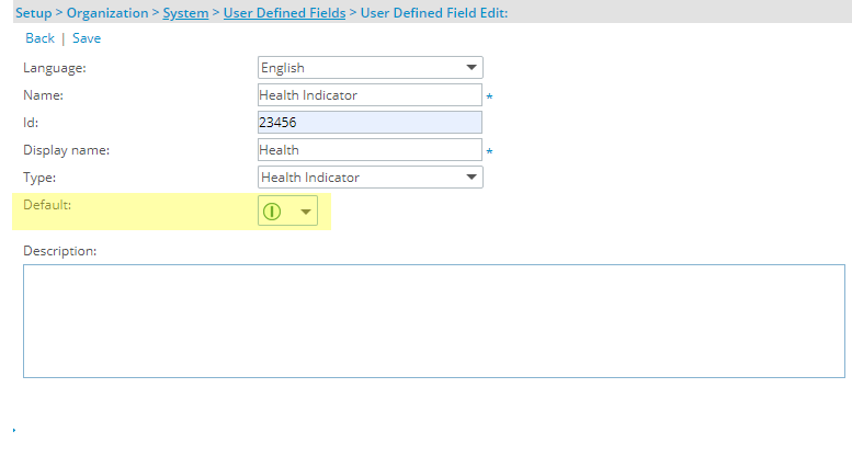

5. Health Indicator
The Health Indicator option gives you the possibility to add user-defined fields that can be used to show the status/health/performance of a specific item they are associated to.
Upon selecting to create a UDF of Health Indicator, you have the option to specify a Default value.
Green: Indicating that everything is on track. -
Yellow: Indicating that corrective actions may need to be taken to prevent problems. -
Red: Indicating that there are problems that need to be addressed immediately.
Note: By default
Green is selected.
