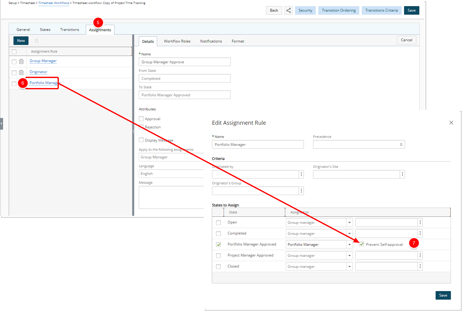

. - From the Navigation Menu click Timesheet.
- From the available menu options select Timesheet Workflows.
- From the Timesheet Workflows list that displays, click the Name of the Timesheet Workflow you wish to access.
- Click the Assignments tab on the left pane
- Select an Assignment Rule you wish to modify
- Choose the Prevent Self-Approval option for a State assigned to Portfolio Manager.
Note:
- The Prevent Self-Approval option is only visible and available when Portfolio Manager is selected as the Assign to option.
- With this options is selected, upon a Portfolio Manager submitting their Timesheet:
- The Portfolio Managers Timesheet will be assigned to their Group’s Approval Manager.
- In cases where the Portfolio Manager’s Approval Group Manager is set as Out Of Office in PSA, their Approval Group’s Alternate Manager will be assigned to the State.
- Click Save then Close.
- Click Save to save the workflow.
