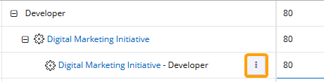

Open the drop-down menu of a "Role" line item from the Demand (bottom) section.
Note: "Role" line items contain both the name of a work item and a Role.
The "Allocation Group By" and "Demand Group By" fields in the Display Settings determine where the "Role" line items will appear when rows are expanded.Select Assign Demand.

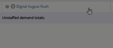

Expand the Role of the unstaffed demand you would like to assign.
Note: Based on the layout's display settings, the unstaffed demand might be grouped by work items instead of Roles. If this is the case, you will need to expand one of the work item parents to see which Roles make up its unstaffed demand. Expanding the Role will list all of the specific work items that contain the unstaffed demand.
See Change the Resource Review Display for more information on display settings.Expand the parent work item.

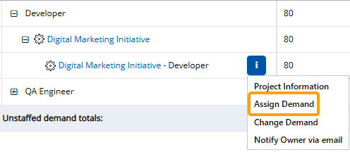

Open the work item's drop-down menu.
Note: If the Assign Demand option is not available, it is likely because you do not have the "Allocate Resources to Demand" Project permission on the work item.
