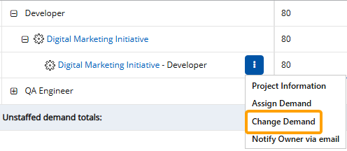

  5. Open the work item's drop-down menu.
  6. Select Change Demand.

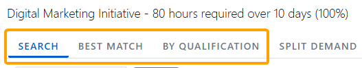

  7. Add Resources to the unstaffed demand using one of the three methods.
    Select any of the methods below to learn more about them:

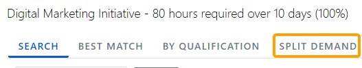

  8. Select the Split Demand tab once you have selected all of your Resources:

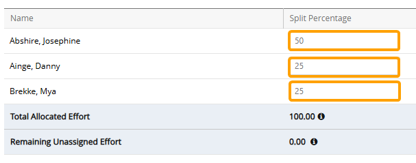

  10. Determine how the allocation or demand will be divided amongst the listed Resources by entering percentages into the "Split Percentage" fields.
    Tip: The sum of the percentages do not have to reach 100%, but keep in mind that there will still be unstaffed demand leftover if this is the case.
  11. Select the OK button.
After selecting OK, the unstaffed demand will be assigned to the selected Resources.

  4. Open the drop-down menu of the work item you would like to assign Resources to:
    Note: You will need to keep expanding work items until you can access the drop-down menu.
  5. Select Change Demand from the drop-down menu:
  6. Add Resources to the unstaffed demand using one of the three methods.

  7. Select the Split Demand tab once you have selected all of your Resources:

  9. Enter the percentage of the unstaffed demand that each Resource will be responsible for in the "Split Percentage" fields:
    Note: Both the total allocated unstaffed demand and the total remaining unstaffed demand will be listed directly below the Resources:
  10. Select the OK button:
After selecting OK, the unstaffed demand will be allocated to the selected Resource(s).
