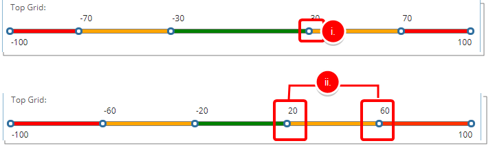

Setting the thresholds (Top Grid)
- From the Heat Map Tolerances section, select the slider and move it to a new threshold.
- Repeat step 1 as necessary.
Note: The default settings for the Heat Map Tolerances sliders for the Top Grid are:
- Less than or equal to -70 for users that are fully booked with very little or no free time. Users falling within this threshold are over allocated.
- Less than or equal to -30 for users with little free time. Users falling within this threshold are a bit over allocated.
- between -30 and 30 for users with very little free time. Users falling within this threshold have just the right amount of allocation.
- More than or equal to 30 for users with free time. Users falling within this threshold are a bit under allocated.
- More than or equal to 70 for users with lots of free time. Users falling within this threshold are under allocated.

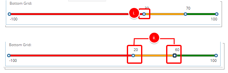

Setting the thresholds (Bottom Grid)
Note: The default settings for the Heat Map Tolerances sliders for the Bottom Grid are:
- Less than or equal to 30% for users with little or no free time.
- Less than or equal to 70% for users with some free time.
- Greater than 70% for users with lots of free time.

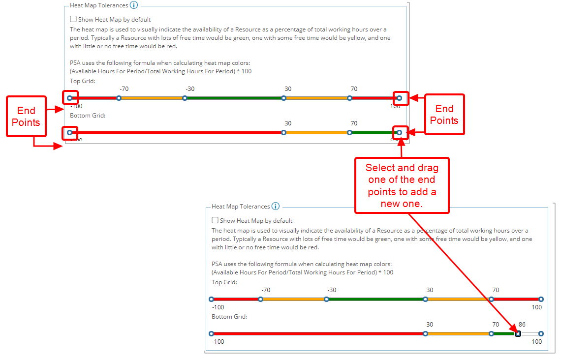

- To add a threshold simply click and drag one of the end points.

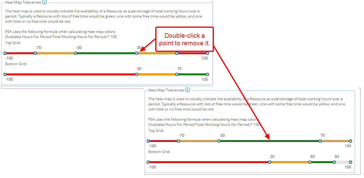

- Double-click a point to remove a threshold.

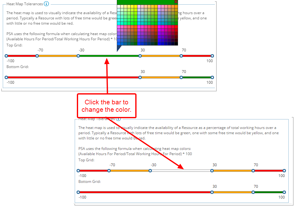

- To configure the background color, click the color bar to access and select a color form the color picker.

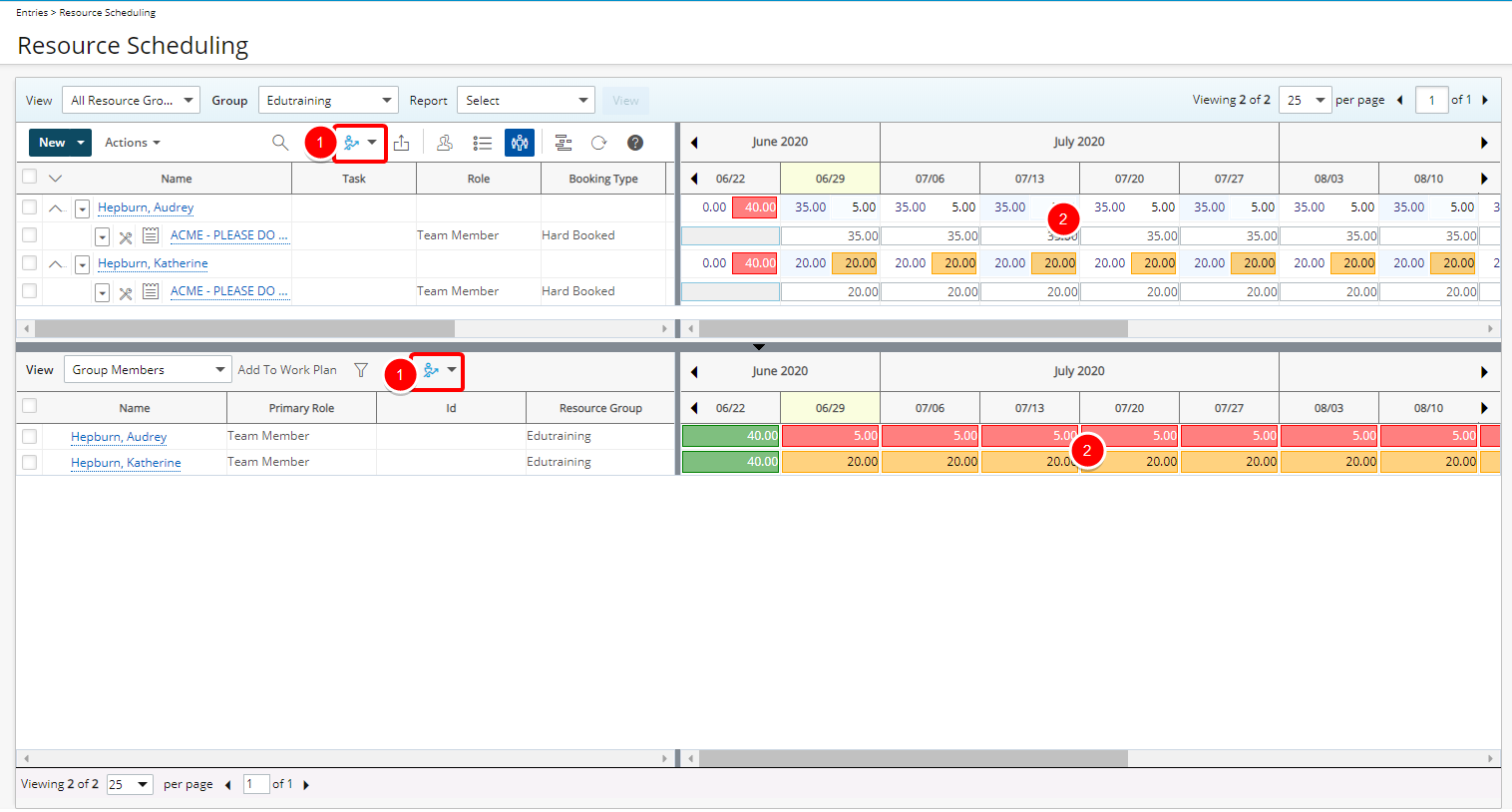

- View Work Plan
- Click the Heat Map button.
- You can now visually see the availability of Users and Roles based on the organizational level threshold settings.
Example: In our example, we removed the background color for -30 to 30 threshold. As a result, when viewing the Top grid, users with just the correct amount of allocation are not highlighted. We can now concentrate on those who are either over or under allocated.
