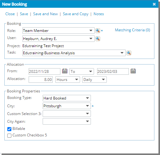

When the Create an Assignment when Hard Booking a User option is turned on, upon Hard Booking a User against a Task, the Assignment is created automatically within the User’s Timesheet.
Note that:
- The Project Planner Synchronize with Timesheet option must be turned off for the Project.
- The Booking is a Hard Booking for which a Task and allocation hours are defined.
- The selected Task is set to be Used by Time.
- User creating the Booking must have the Create right to Assign Users to Task (Setup > Work) permission in their Security Profile (Setup > Organization > System > Security).

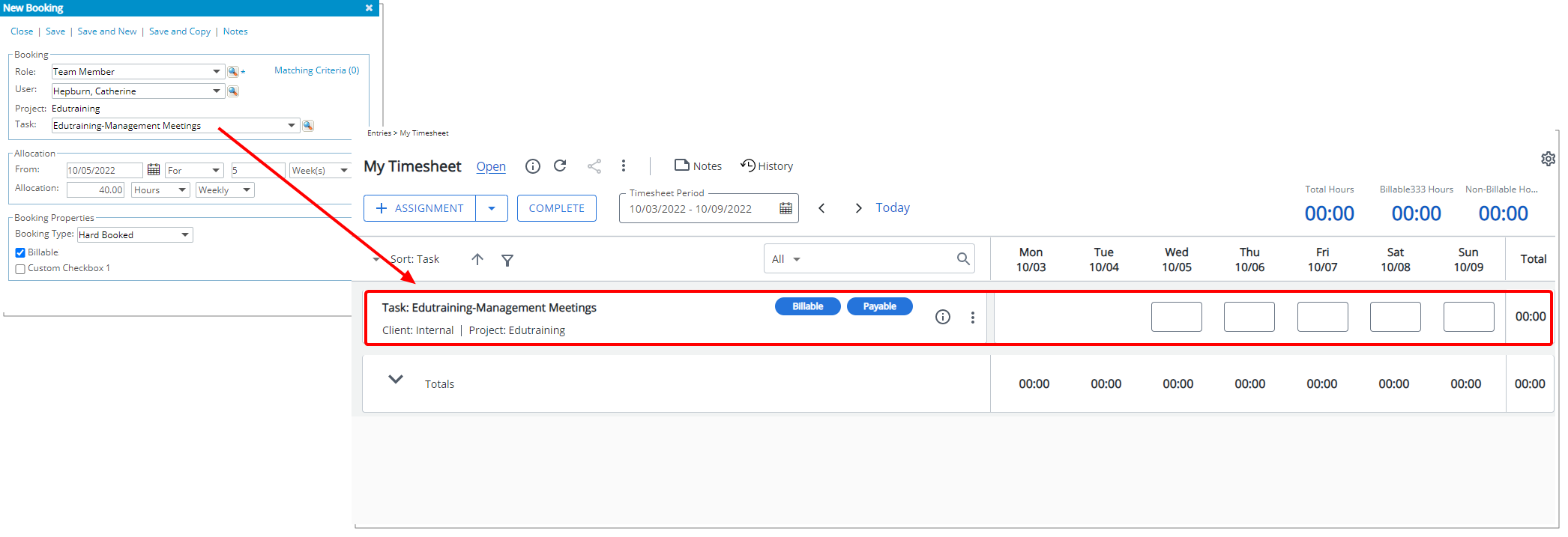

- Upon navigating to a Work Plan, create a Hard Booking wherein a Task and allocation hours are defined ensuring that all Prerequisites are met.
- Navigate to the Users Timesheet and note that the Assignment is created for the User:
