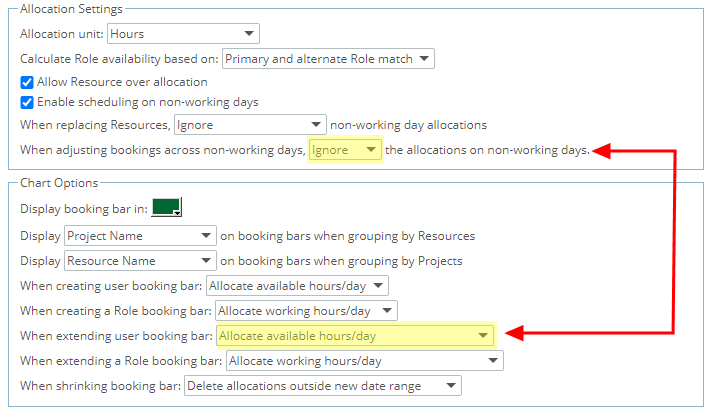

1. Extending the Booking Bar
Chosen settings:
- When replacing Resources, Ignore non-working day allocations
- When extending user booking bar: Allocate available hours/day
- The hours on the non-working days will be left as-is.
- The hours on working days will be left alone, and new days in the period will be allocated with the available hours on that day.
- If there are multiple non-working day assignments inside the new range, both non-working periods will be left intact.
Example: To illustrate this with an example, let's say we have allocated 8 hours/day for 7 consecutive days: (Mon 6th to Sun 12th) for a total of 56 hours.
Sat 11th and Sun 12th are non-working days.
If we drag a bar to add one extra day (Mon the 13th), we would leave the 40 hours (originally 8 hour per day for Mon 6th to Fri 10th) and add the available hours for Mon 13th to that day.
Sat 11th and Sun 12th will stay as they were assigned at 8 hours/day.

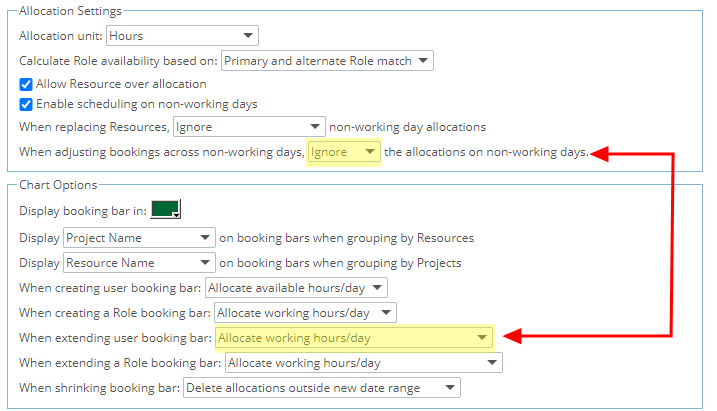

Chosen settings:
- When extending user booking bar: Allocate working hours/day
- The hours on working days will be left alone, and new days in the period will be allocated with the working hours on that day.
Example: To illustrate this with an example, let's say we have 8 hours/day assigned for 7 consecutive days: (Mon 6thto Sun 12th) for a total of 56 hours.
If we drag a bar to add one extra day (Mon 13th), we would leave the 40 hours (originally 8 hour per day for Mon 6th to Fri 10th) and add the working hours for Mon 13th to that day.
Sat 11th and Sun 12th will stay as they were assigned at 8 hours/day .

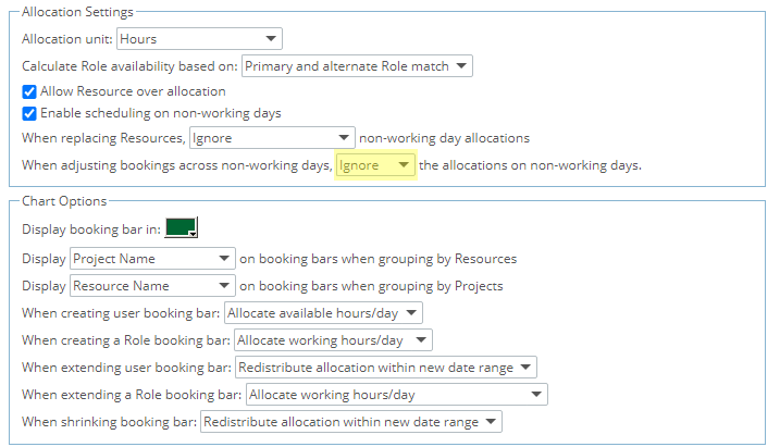

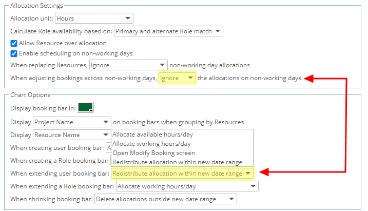

Chosen settings:
- When extending user booking bar: Redistribute allocation within new date range
- The hours on working days will be redistributed across the new range.
Example: To illustrate this with an example, let's say we have 8 hours/day assigned for 7 consecutive days (Mon 6th to Sun 12th) for a total of 56 hours.
If we drag a bar to add one extra day (Mon 13th), we would redistribute the 40 hours (originally Mon 6th to Fri 10th) across the new period (Mon 6th, Tues 7th, Wed 8th, Thurs 9th, Fri 10th and Mon 13th).
Chosen settings:
If we drag a bar to add one extra day (Month), we would redistribute the 40 hours (originally Mon 6th to Fri 10th ) across the new period (Mon 6th, Tues 7th, Wed 8th, Thurs 9th, Fri 10th and Mon 13th).

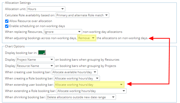

Chosen settings:
- When replacing Resources, Remove non-working day allocations
- The hours on the non-working days that fall inside the extended range will be deleted.
- The hours on working days will be left as-is, and new days in the period will be allocated with the available hours on that day.
- If there are multiple non-working day assignments inside the new range, both non-working periods will be deleted.
If we drag a bar to add one extra day (Mon 13th), we would leave the 40 hours (originally 8 hours/day for Mon 6th to Fri 10th) and add the available hours for Mon 13th to that day.
Sat 11th and Sun 12th will be removed.
Chosen settings:
- The hours on working days will be left as-is, and new days in the period will be allocated with the working hours on that day.
Example: To illustrate this with an example,let's say we have 8 hours/day assigned for 7 consecutive days (Mon 6th to Sun 12th) for a total of 56 hours.
If we drag a bar to add one extra day (Mon 13th), we would leave the 40 hours (originally 8 hours/day for Mon 6th to Fri 10th) and add the working hours for Mon 13th to that day.

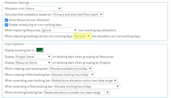

Chosen settings:
The hours on the non-working days will be removed.
If there are multiple non-working day assignments inside the new range, both non-working periods will be removed.
If we drag a bar to add one extra day (Mon 13th), we would redistribute the 40 hours (originally Mon 6th to Fri 10th ) across the new period (Mon 6th to Fri 10th and Mon 13th).
Sat11 / Sun12 will be removed.

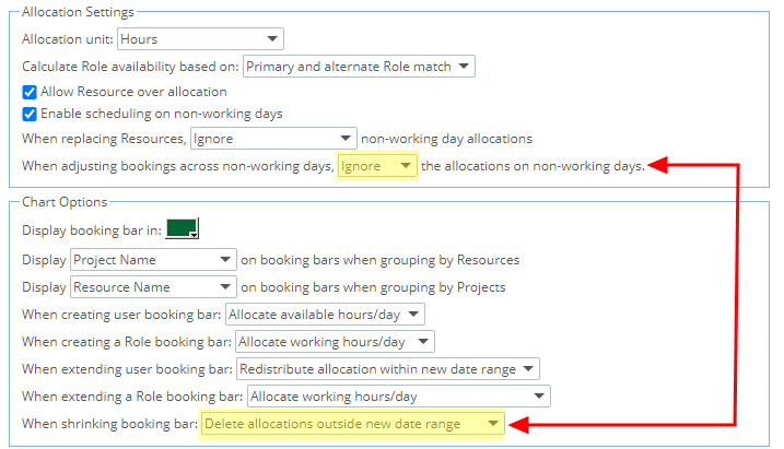

2. Shrinking the Booking Bar:
Chosen settings:
- When adjusting booking across non-working days, Ignore the allocations on non-working days
- When Shrinking user booking bar: Delete allocations outside new date range
When shrinking user booking bar:
- The hours on the working days outside the new range will be deleted.
- The hours on non-working days outside the new range will be left as-is.
- The hours on working days inside the new range will be left as-is.
- The hours on non-working days inside the new range will be left as-is.
Example: To illustrate this with an example, let's say we have 8h/d assigned for 6 consecutive days (Thurs 9th to Tues 14th) for a total of 48 hours.
Sat 11th and Sun12th are non-working days.
If we drag a bar to Fri 10th (which would remove Mon12th and Tues 13th) then the hours from Mon 12th and Tues 13th would be deleted.
The hours from Thurs 9th, Fri 10th, Sat 11th and Sun 12th would be left as-is.
Chosen settings:
- The hours on the working days outside the new range will be redistributed to working days in the new range.
Example: To illustrate this with an example, let's say we have 8 hours/day assigned for 6 consecutive days (Thurs 9th to Tues 14th) for a total of 48 hours.
If we drag a bar to 10th (which would remove Mon 12th and Tues 13th) then the hours from Mon 12th and Tues 13th would be redistributed across Thurs 9th and Fri 10th (total of 32 hours being redistributed).
The hours from Sat 11th and Sun 12th would be left as-is.

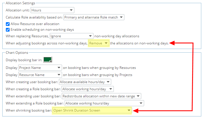

Chosen settings:
- When extending user booking bar: Open Shrink Duration Screen
- The hours on the non-working days outside the new range (but inside the original range) will be deleted.
- The hours on the working days in the range will be updated using using the chosen settings within the Modify Booking dialog box.
