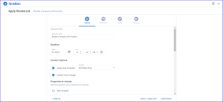

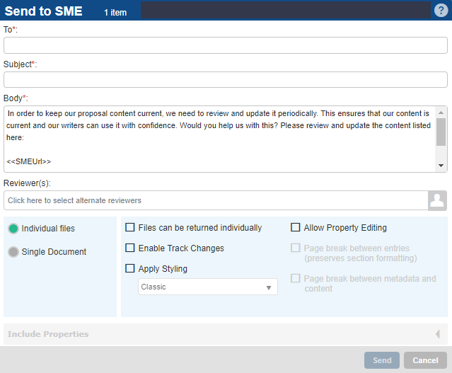

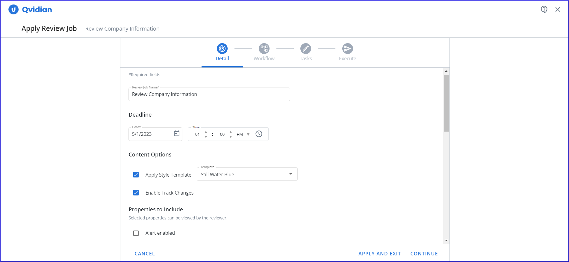

Example of the Content Assignment dialog box (left) and the Send to SME dialog box (right).
Content managers can use content review jobs to manage reviews of content records in the library. This feature is similar to Send to SME, but it is more robust and only available to licensed Upland Qvidian users. Content managers can track progress of reviews add multiple tasks with multiple users, and create activity reports.

If your SME is not a licensed Upland Qvidian user, you can use Send to SME to create SME jobs. These jobs can include either individual files or a single document that is a composite of files. SME jobs do not require users to download the Upland Qvidian Add-In toolbars.
